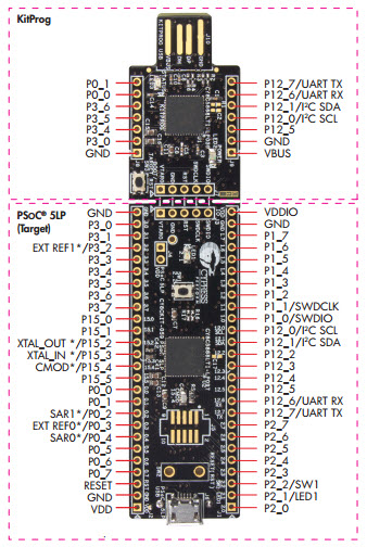

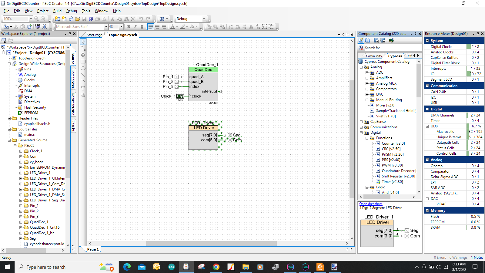

One possibility (single chip) :
Basically use the quaddec component, 32 bits, (a component in PSOC land is an onchip resource)
and the led 7 display component. One possibility. Would take some code to periodically read
QUADDEC and write the RAM locations associated with each display digit. Design method is drag
and drop a component onto canvas, dbl click to config, and access datasheet for APIs description
used for that component. You then wire up part with a wizard (its routable internally and out to
pins).

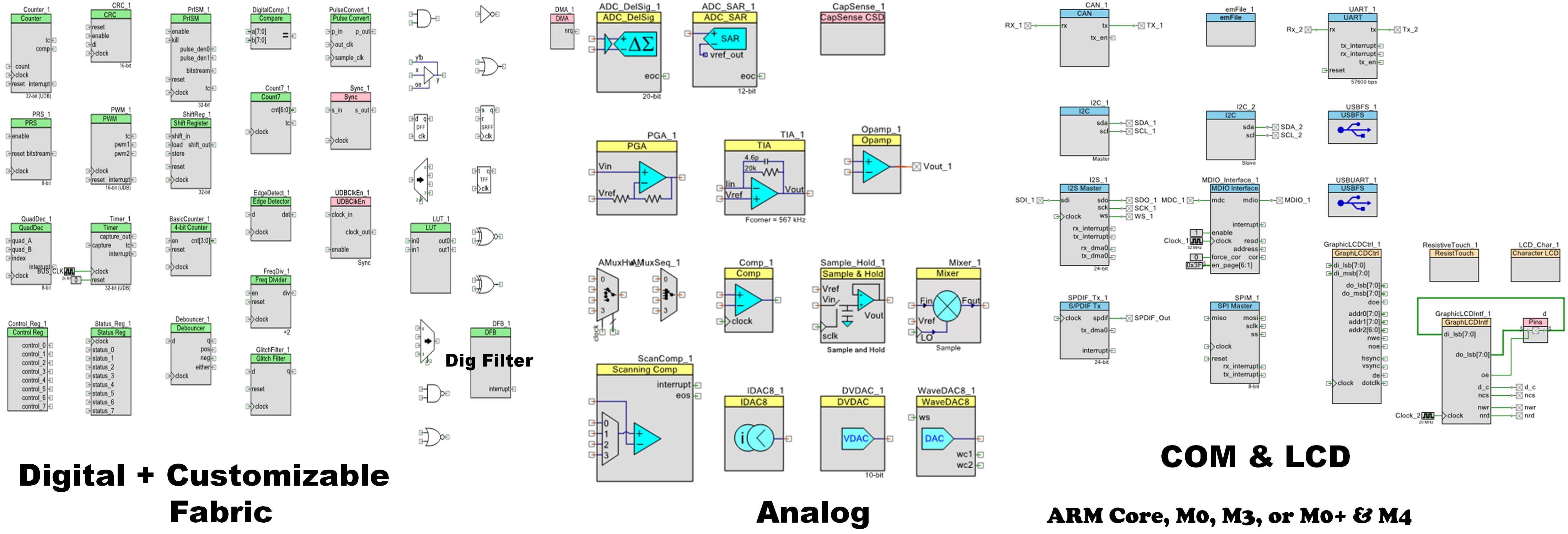

Or use 7 LUTs (also onchip) and code them for BCD counting, 6 for count, 1 for binary to segment conversion. Or use basic logic onchip to create the equivalent of the 74HC90 BCD counter and
cascade those......Note you can create your own "component" by using schematic capture and/or
verilog. An example of community created components -
Here is whats on chip in standard chip library (multiples of many) -
IDE (PSOC Creator) and compiler free. Board to use possibly CY8CKIT-059 ($15) :
There are boards with a lot more I./O but seems you do not need that much.
I am not an experienced user of QUADDECs so here is the datasheet for the onboard component :
You could post at Infineon website for more complete help.
Regards, Dana.

The quaddec counts at 32 bit res to 28 Mhz, way overkill for what you are doing. More
than adequate to use.
The latency I was referring to is not the counting speed, rather the digit parsing and
write out to display, eg. updating the display. I think easily can do 10 Khz update rate.
Of course human eye cannot perceive this rate.
Yes on count up/dwn, and reset (thats a simple write).
Notice you could sub a more pleasing graphic display as there is onchip graphic controllers
to manage that. OLED that sort of thing. If you look at right hand column of IDE project I
showed only a small fraction of chip resources used. Lots left for other needs/wants in design.
Like battery monitoring, motor drive current monitoring (detect early lube failure), control and
monitor led pointer drive...........
By the way the PSOC 6 family would permit you to do all this in BLE if you so choose.
Regards, Dana.

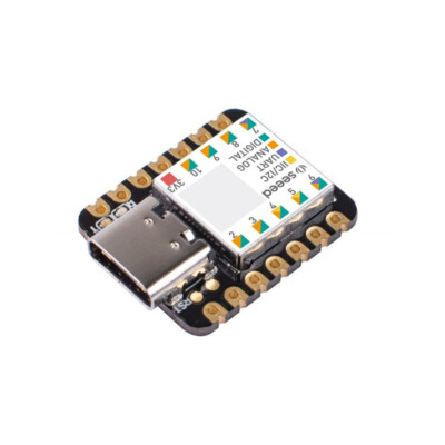

For the speed you need, you don't need hardware quadrature counting, it's easily done in software.
Any even moderately fast PIC MCU would do it, though some in the motor control series do have hardware encoder interfaces.
The cheapest and with simplest construction would be something like a Seeed Xiao M0 MCU module - they are tiny, cheap and stupidly powerful (32 bit ARM CPU at 48MHz, with masses or RAM and flash).
eg.

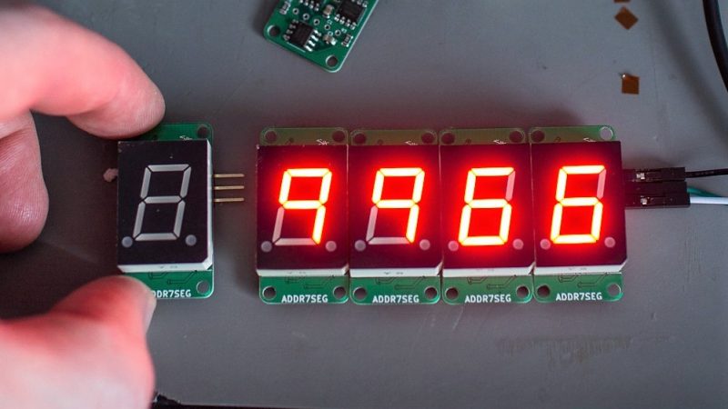

Plus a serial/SPI interface display - there are many different types, with different numbers of digits or stackable modules to make any size display you need.
Or starburst rather than seven segment:
