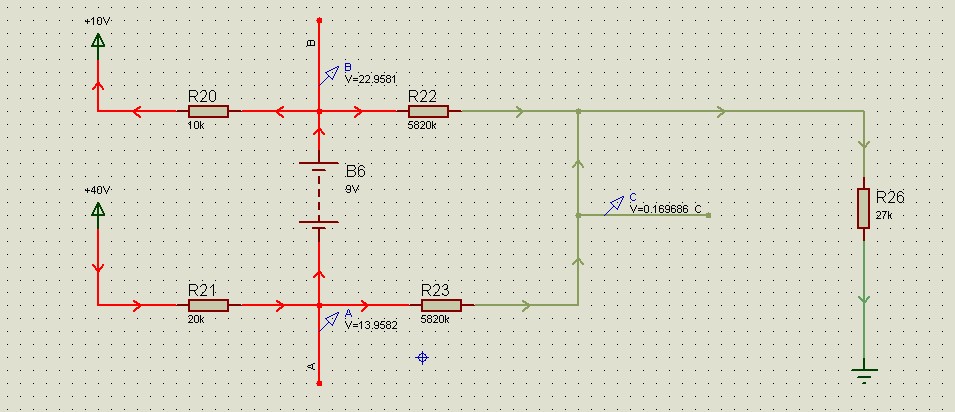

Hi everyone,Please help me analysis this mixed combination resistor circuit, Pin A,B,C output voltage and current, include how to simple circuit, and calculation formula,Thanks!!!

They have already given you the source voltage and the nodal voltages for A, B and C of the circuit arrangement. Surely, with that information, you can derive the nodal currents.
And, with that information, you should be able to simplify the circuit.

Thank for all reply,i want know Pin A,B,C voltage and current ,how to calculation formula by KVL and KCL.Battery 9V let me confusion.

As best I can tell, you're not paying attention (which may explain why you're having to ask the questions that you are, repeatedly).
How about show us what calculations you have attempted thus far?
