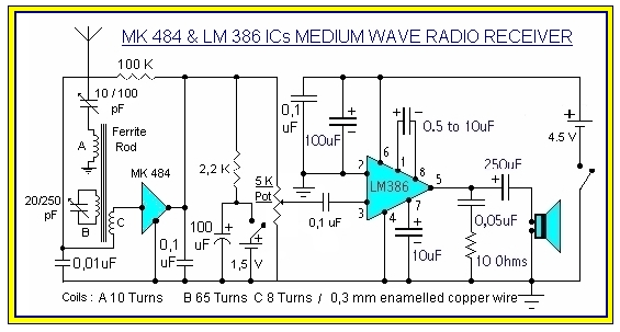

Hello,
I have found the MK484 IC which is a three pin IC used in a simple radio. It is a ten transistor amplifier with automatic gain control.
I am wondering if it comes in SMD or if anything similar to it comes in SMD.
thanks,
George L.
Here is the Datasheet and a link to an AM Radio with an LM386 Amp.
