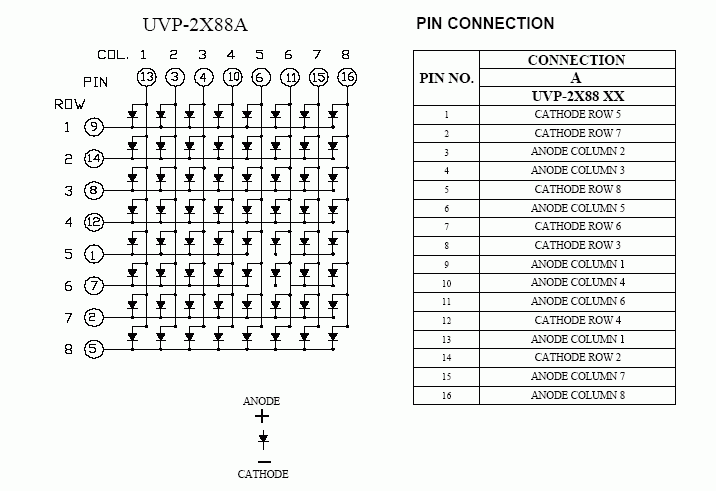

ML-2088I\J LED Matrix Display Search results
KMP-2088BSR (ML-2088I\J)
UVP-2088
  • UVP-2088.pdf
Here is what I got from the Datasheet.
