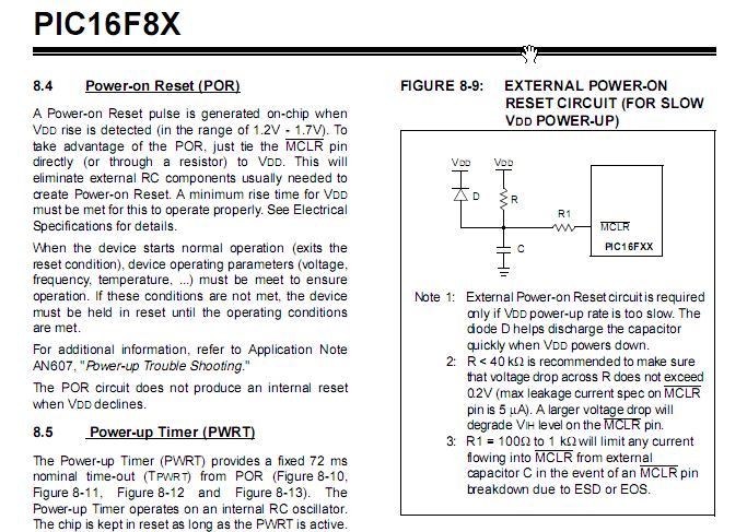

what happens if i will leave out the MLRC part of the circuit (dont include the 20k resistor and the 472 ceramic), you think it will still function?

It depends upon how you have assigned the MCLR pin in the CONFIG of your program.
Whats the PIC type.?
PIC is 16f84A. here's the schematic and im using it for serial communication.
heres the code and ive simulatide this and worked.

As Nigel's circuit shows it, the MCLR res/cap is required.

The 10pf caps on the crystal may be a little low. 22pf is a better choice. Also you'll need 0.1uf caps near the VSS & VDD on the PIC
I've avoided the cap on MCLR as it can mess up ICD programming.
Probably not, but it will probably randomly reset on you. The resistor MUST be there for this to not happen. Reset pins should never be left floating.

neither the cap nor the resistor is needed: they form a low pass filter to improve resistance to random interference, and the cap holds the mlrc pin low briefly during power on.
