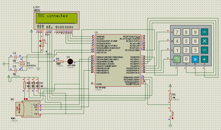

I bought the EasyPIC5 and the MMC/SD Card which is able to connect to PIC,AVR or 8051, but I couldn't get it working.
I don't now the problem, PIC18F4550 use PortB and PortC to connect to MMC card.
I tried to use the example on the MikroC ver. 8.0 but it is for PIC18F4520 with use PortC only.
If some body can help me in any kind I will appreciate it.
Thank you all
If I remember correctly, the MMC board from mikroE does not have level shifting so return data to the uC are 3V (and that 18F4550 runs on 5V). If you lower the voltage of the 18F4550 to 4.5V it will work or if you put a level shifter between mmc and port ...
you can also check forum.mikroe.com for more details as they provide "closed" libraries with mikroC so their forum is really the best place to get support for their products
But MMC with PIC18F4550 works on Proteus

The Program is working fine on Proteus.
If the code work on proteus and not on hw, the 3v-5v is what is messing what you... the output from mmc is 3v and input on pic is 5v .. you also do not have a voltage divider for pic to mmc .. you can "kill" some of the cards as some of them do not have 5v safe inputs ...
the proteus "ignore" all this problems .. it will work even if you remove the pull ups (in proteus) .. in real life - it will most probably kill the mmc ...
the pic to mmc lines - use voltage divider to get the signal from 5v to 3v
the mmc to pic line - either use some level shifter for 3-5 shift or lower the pic vcc, if you lower the pic vcc to 4.8V or 4.5V it will lower the threshold and 3v will be recognised as high signal.
check out the: https://www.electro-tech-online.com/custompdfs/2009/02/3_3vto5vAnalogTipsnTricksBrchr.pdf
