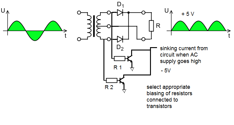

what is 0 amd - 5 V , is it reverse direction of current ?
it means a power supply with positive and negative output, fixed at -5 and +5 with a common termainal.
so you want 3 terminal device , one as a source of +5V, second as neutral 0V, third as sink of - 5V .
but from where will - 5V source it current, you just cannot have a terminal sinking current without something connected to it.
if its going to sink from circuit connected, i say you use transistor to sink current , i dont know if this circuit is going to work but i am going to paste it.
select appropriate values of components connected.
