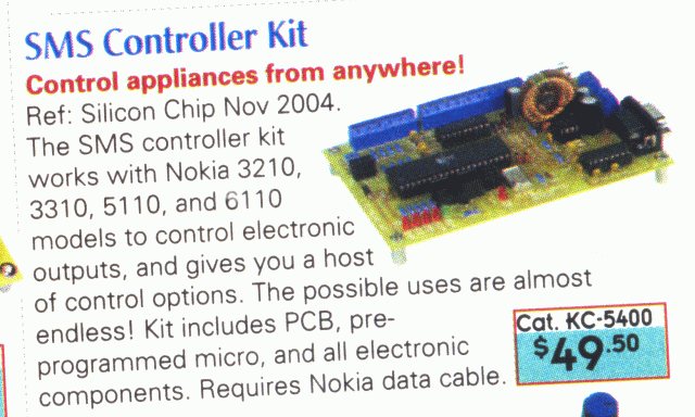

Siliconchip did a project in the last year which interfaces with a nokia phone. Basically the project sends you an e-mail when something happens ie: a relay trips etc. Below is a picture of the kit which is available from www.jaycar.com.au . If you go to www.siliconchip.com.au and search for that project you can read up on all the features.
Cheers Bryan :D

thanks for the replies, i have been looking for something like that. but my only problem is, after reading that it doesnt say anything about phoning the alert, only txt / sms. Also how is it programmed? i assume its through the mobile phone, or messages to it??
i will probably have to go for it if i dont find another soloution. but i was wanting it to phone me, ring for a bit, then hang up and do it again. this way, there are no delays in receiving the message like on sms which has been known to take 24hours or more on some occasions to be recieved. and it wont cost anything, as no connection is made, it just rings.
i want it to be as maintanence free as possible, ie i dont really want to top up the credit on the phone or check what its got left.
although please correct me if im wrong and it does phone out. that would be perfect.
