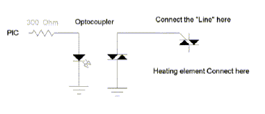

How can i connect MOC3041 to 220 V, AC element heater ?? do i need any extra parts ?? (circuit diagram if available)
Basically this is what you need.
I just drew this circuit for illustration purposes.
