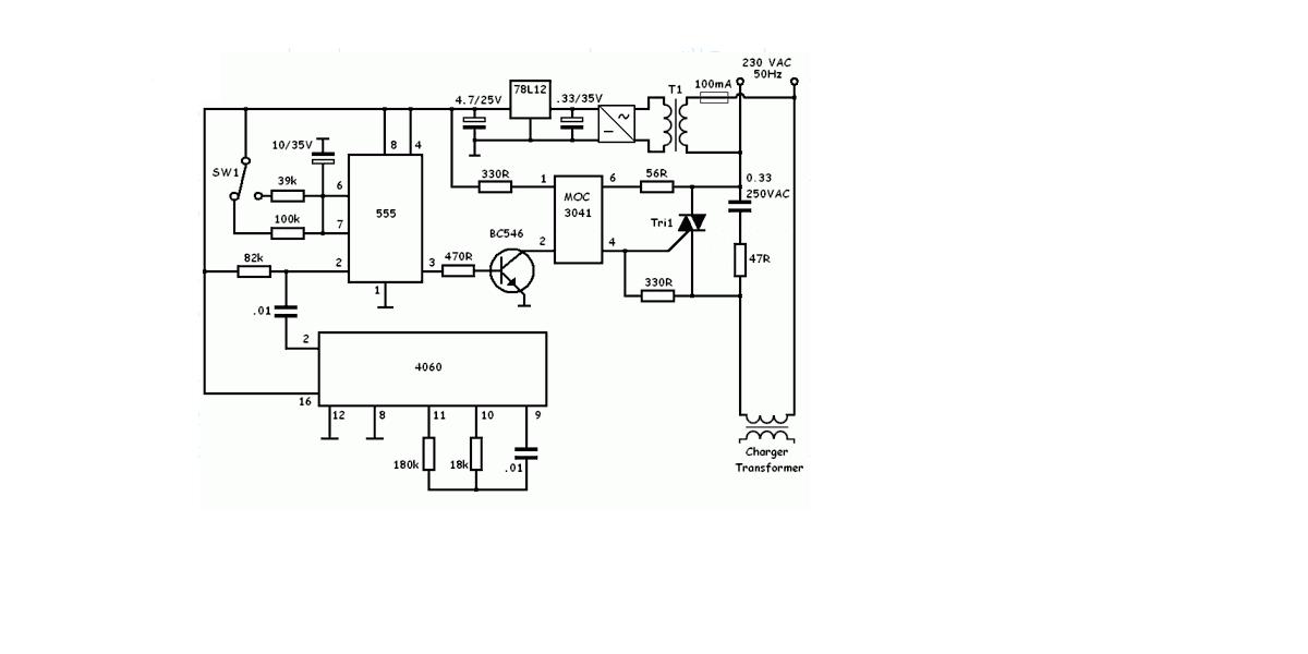

how to know that the triac fired thru MOC3041 is @ zero crossing of mains ? I have a pulse charger switching circuit, which makes thumb like sound when the triac fires..have a feeling that the MOC is not working properly or is it because of inductive load...any suggestions to make it soft switch ? Thanks in advance..

The load is the primary of a 300 Watts power transformer the secondary is bridge rectified and fed to a battery.
Please find the circuit...attached..

Ok..thanks for ur replies,,,,BY the way did u see the circuit i posted ? can we replace CD4060 & 555 with a dual 555 ie 556 ?
There is nothing wrong with the circuit as connected.
The thump will occur whether you like it or not as I assume there is a large capacitor connected to the rectifier on the transformer's secondary which will cause a huge current surge when it charges up. This huge current surge will cause the transformer's windings to vibrate and emit a thump sound.
So why not put a bleeder resistor across the Capacitor like they do on Electric Motors?
