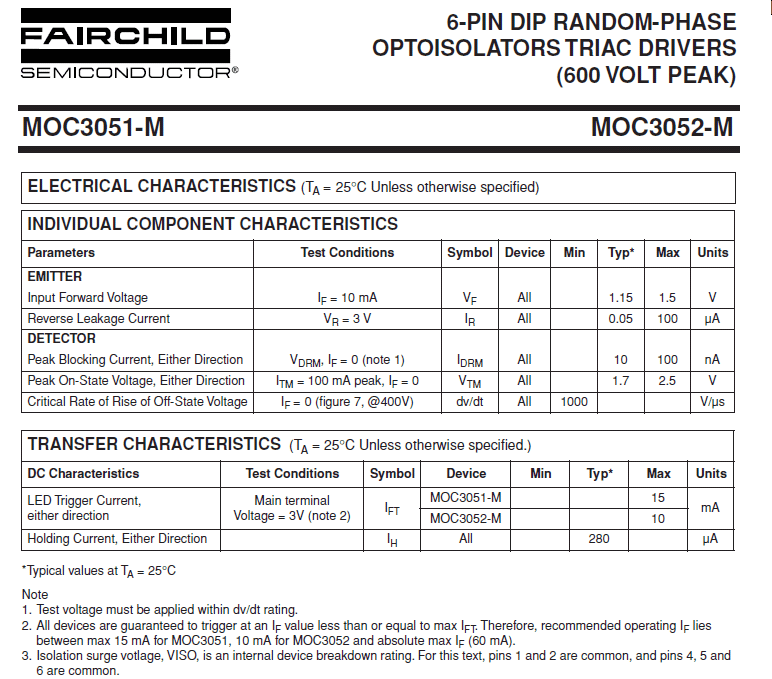

I need a moc3051 but, I can only find a PC817 or related in LTspice, I need a non-zero cross.
My question is can I drive a Triac in my simulation with the Transistor I'm using 2n222 to drive moc3051.

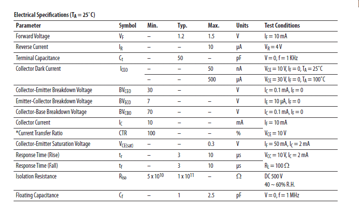

hi kv,
This zip has the 4N27 and 4N35 opto coupler data for LTSpice, also a example asc file.
The 4N35 is close enough to stand in for a MOC3051.
The 4N35h ,hierarchical is included, so you can modify that to Sim a MOC3051 if required.

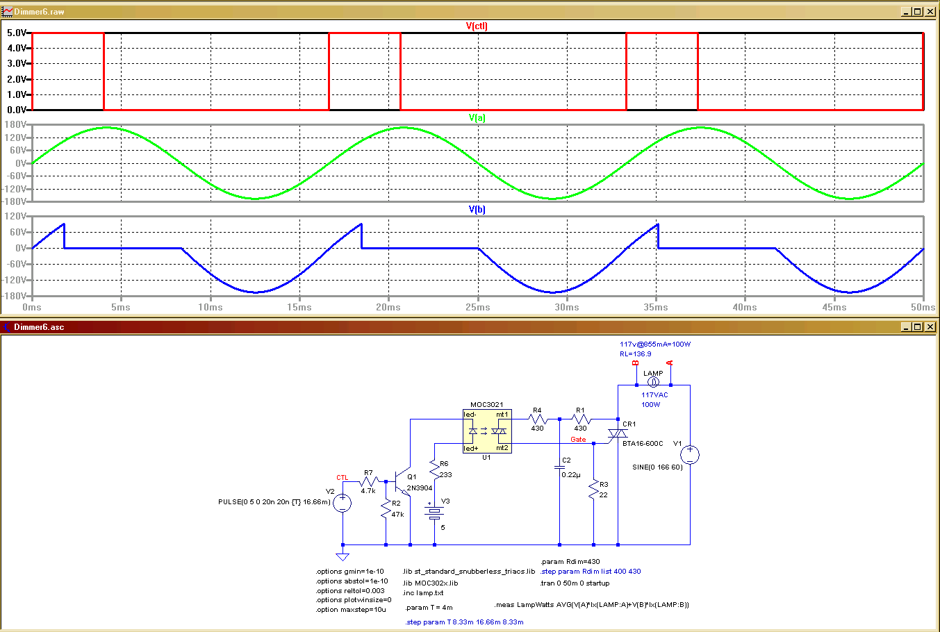

I think I can Modify the 4n35h, I had a circuit designed about 30 years ago, it could detect water and run a Triac to power motors, buzzers, light etc. But while it was designed to do that it also had resistor circuits that would run IR detector that would sense when a device needed cleaning, lint etc. In this case I would like to put a Photo detector circuit in to turn on and off the 2n222 and run the Triac.

Found this one the in the forum that would closely match what I'm doing, maybe I can modify this one.
kv

hi kv,
I guess you have the *.lib files for the snubber, triac and lamp models.?

hi kv,
I downloaded your zip and extracted the files you need to RUN dimmer6.asc [ also in the zip]
For now keep all the unzipped files in the same folder
E
