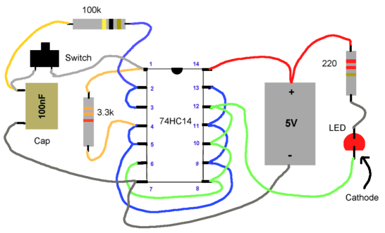

I have a momentary push button switch and wanna be able to turn a LED On and Off with it.

This will do it :-
here we go :(
i cannot read or understand wiring diagrams..
only way i can get something like this togheter is to get a complete list of parts needed including like a paint-like drawing of how it need to be wired haha.
thanks anyway!
Ok then, here's a drawing :-
....and here's the recipe :-
Ingredients
1 x 5V supply
1 x 14-pin DIL socket
1 x momentary action switch
1 x 74HC14
1 each of 100kΩ, 3.3kΩ and 220Ω resistors (1/4 watt or less)
1 x 100nF (= 0.1 uF) capacitor (polyester)
1 x LED
Hook-up wire
Method
Familiarise yourself with anti-static precautions needed for handling CMOS circuits.
Note that there is a notch or other mark at one end of the 74HC14 chip to help identify pin 1.
Observe the correct polarity of the 5V supply and the LED (the LED cathode is usually shorter than the anode lead, or there is a flattened section of the LED body nearest to the cathode, or the 'cup' inside the LED is usually the cathode).
Leaving the chip to last, wire the DIL socket to the other components as shown, then insert the chip.
Note: depending on the LED you use it may be necessary to change the 220Ω resistor to one with a value in the range 100-560Ω to give a suitable brightness.
Happy cooking!

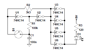

Try 1kΩ for the resistor. Even with that the IC will struggle and its output pin voltage will drop and drive < 7mA through the LED. You could connect gates within the IC in parallel to boost the drive current. The inputs of any unused gates of the IC should be grounded to prevent circuit instability.

If shorting the jack input to ground, as you seem to be doing at the moment, doesn't harm the reverb then the following circuit (adapted from the earlier one) should do the job. The transistor switches on when the LED switches on, and its collector is pulled down to ground. The transistor can sink > 10mA, which is probably sufficient.
