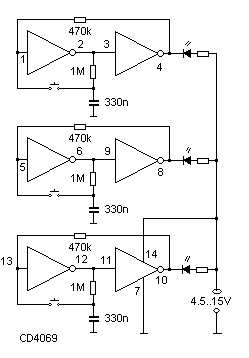

Hopefully a simple question for you guys - whats the easiest way to do this? Basically have a momentary button that with a press changes the output to the opposite of what it was? (ex logic high/low) any suggestions on an IC or a simple discreet circuit to do this?
