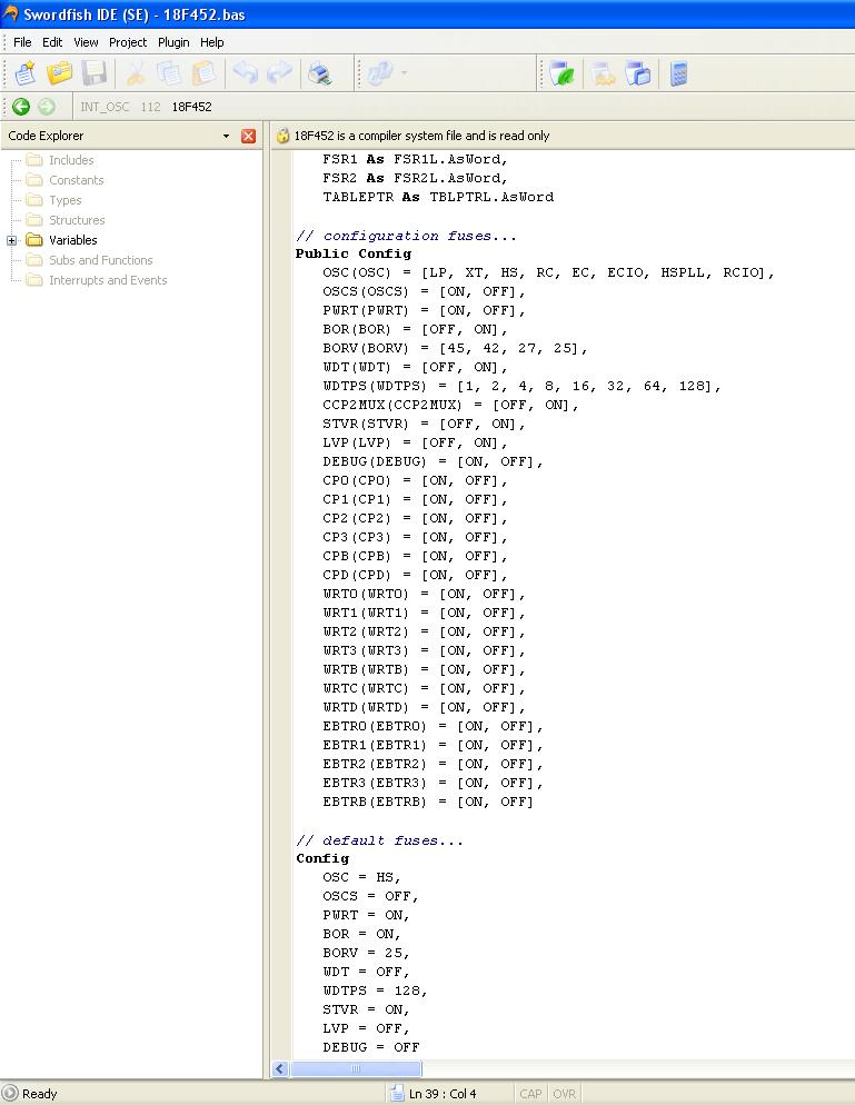

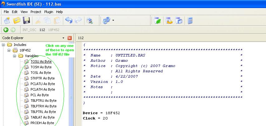

Just on configs, Swordfish will produce the required config code aswell, just open the PIC's file, as shown in the attachments, and then scroll right to the bottom - theres a list of config settings.
To change configs at the start of your program, just put;
Device = 18F452
Clock = 20
Config
   OSC = HS,
   OSCS = OFF,
   PWRT = ON,
   BOR = ON,
   BORV = 25,
   WDT = OFF,
   WDTPS = 128,
   STVR = ON,
   LVP = OFF,
   DEBUG = OFF
Now when you open the .hex in IC-Prog/WINPIC, all the options will be chosen by default (well they already will because they are included in the 18F452 core file, but now you can 'override' the default configs)
