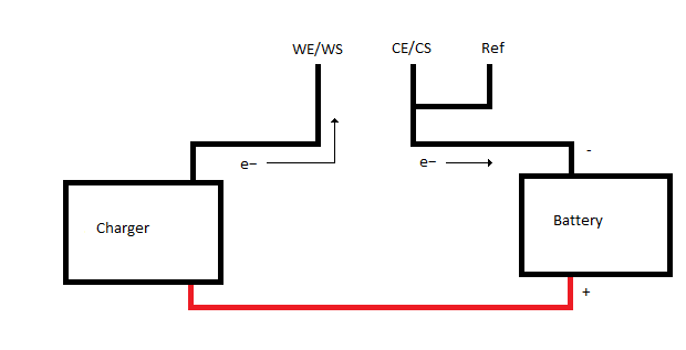

Hello, everybody! Sorry if I have posted this in the wrong forum, but this one seemed appropriate. I want to hear your ideas about a setup I will build. I want to register the current a charger is providing to a battery during the charging period.
The charger uses CCCV charging (constant current up to 4,2V, then constant voltage until the current is ~5% of the original current).
I will use a potentiostat connected as a ZRA (zero resistance ammeter) to monitor the current. You can read the instructions on how to connect it if you want here, "Special Case Setup: ZRA Mode" at the bottom of the page.
WE = Working electrode
WS = Working sense
CE = Counter electrode
CS = Counter Sense
Ref = Reference electrode
I will then program the potentiostat to keep a 0 net voltage drop between WE and CE.
What are your thoughts here: will this setup work in monitoring the current during charge?

Will the "Potentiostat" measure the current which you are likely to get from the charger?

The potentiostat is the only equipment I have access to that can log the current and time automatically.
Yes, the potentiostat will measure and log the current as it varies through the whole charge process, for approximately three hours.
OK but what is the maximum current that the Potentiostat can measure, just reading the application note in your link it seems to be a very low current device.
Is it rated to measure the expected charging current?
It is a pretty advanced potentiostat actually, it can be set to different ranges. The current is expected to be between 20 mA and 0,2mA. The potentiostat can handle currents atleast down to one microamp. As long as the setup is right it shouldnt be a problem. Are you familiar with zra setups?

Well, it didn't work. Now I'm off to Scotland with a chainsaw, where you at? :p
I am logging the current manually instead with a simple old multimeter instead, sigh...I am confused why it didn't work. I will post in this thread if I find a solution.

I probably would have put your Ref terminal at the red line or common at the bottom of your picture.

I have built ZRA's or as I prefer to call it, a 4-terminal ammeter with bias but for a different purpose.
My comments would be:
1) Ammeter range
2) How might you measure the battery voltage, That should be important too. It's possible that by moving ref to the bottom of your diagram, you might be able to measure both current and battery voltage PROVIDING the voltage and current ranges of the instrument are compatible with the setup.
