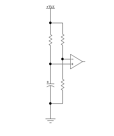

Could anybody show me how to do a a monoshot with about 10Seconds low at output?
It should be op amp based.
Use a couple resistors to make a divider to give a voltage reference to the op-amp. Then charge a cap. When the cap reaches your ref voltage the output goes high.
See attached.
Note it is not self-resetting.

Now I face another issue. ActuAlly I need 100% duty cycle monoshot. Hope I am correct in terminology. When my first monoshot period is over sometimes if the condition that triggered this monoshot( in my case it is a short circuit) still exists the next monoshot should start. the circuits I am trying cant do that beacuse it needs a recovery time to trigger again. how can I overcome this problem?
After the first monoshot pulse Within microseconds I should be able to fire the next monoshot.
Is it possible ? if op-amp cant do it could 555 do it?
I need a output which goes high or low (preferably low) and stays there 10 seconds for every input pulse. I thought monostable and monoshot are same . right?
