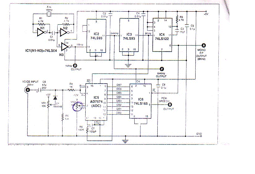

Hi Eric and Hero,
I've attached the the circuit diagram
Can u plz explain the possible reason for using the 74122 IC.
I've also attached a datasheet of 74165 for your convinience:)

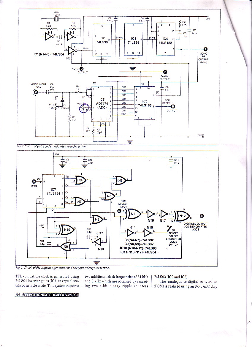

R3, 4k7 and C3, 1000pF give an output pulse of approx 2000nanoSec.
This pulse parallel loads the LS165.
The pulse also goes to an external circuit on pin 'A' and the PCM code is input from the same external device.
Without seeing the circuit for the external device I would say the short 2000nS pulse is also required for timing of the external circuit.
Do you have a diagram of the external circuit,?

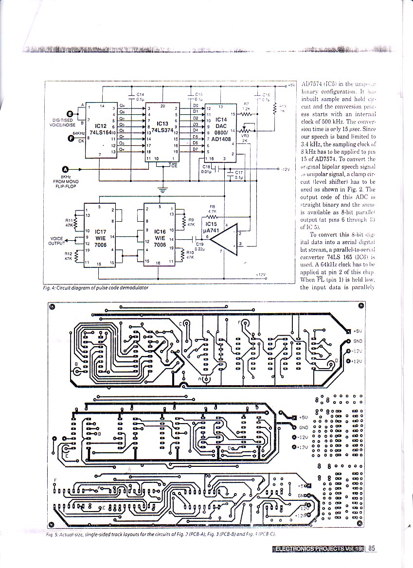

On fig#4, the LS164 is a serial input, parallel output shift register.
The digitised voice is the serial input and the parallel output is connected to the LS374 an 8 bit Latch..
The latch is strobed by the 2000nS pulse and so the output of the latch is steady during the DAC conversion period.
As I said earlier the short pulse from the LS122 is required to strobe the LS374 data latch which inputs to the DAC.

Why is it neceesary to give pulse of width 2micro-sec.Will it not do if i connect 74165 and 74374 directly from the output of second 7493 ripple conter
As Eric has said, the Ls122 is setting up a pulse width to load the shift register with 8 bits. The Load Shift/load pin on the LS165 is level sensitive as opposed to edge triggered as in a D flipflop. This is first weakness in the design as this make the system asynchronous. Second bad choice was using a monostable in a digital circuit where timing is important. The reason is that the analog portions of the LS122 will drift over temperature and timing will shift possibly introducing timing errors. I am sure this works fine for many applications, but in general this sort of design is bad practice.

The monostable 2uSec latches a 'fast, short, slice' of the audio waveform, you dont want the input to the ADC varying while conversion is taking place.
So dont connect the 7493 directly to the latch else you will get severe distortion.
Whats the problem in building the circuit as designed using a LS122.
Because your loading digital bits into the register based on the level output of the 122, over temp, the level timing will shift and possibly lose a bit. With only 8 bit data, 1 bit error will be noticeable. Aside from the analog front end, I was always taught to leave analog out of the digital domain.

The issue I see is shown in my cheesy timing diagram.
The 122 part is temp and voltage dependent which makes it less reliable in a digital circuit. Of course I have not done the timing setup and holds, but drifty circuits as in the 122 can pose a problem. As I said, I am sure it is fine but I avoid such circuits as a general design rule.

The mono 2uS pulse is essential for correct timing operation of the ADC and DAC converters.
I have never had a problem with drift in a LS122.
Alas we are at an impass as I have failed to make my point. I would say this is a design philosophy issue and I doubt I can turn your thinking to my side.
As one can never precisely predict performance of an analog part from batch to batch, over temp and over voltage, there may be pitfalls. I did find a supporting author to my point.
See section 8.22
