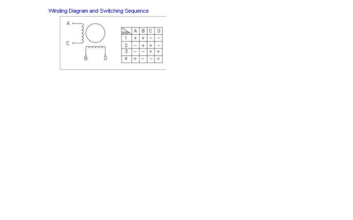

In my project i plan to use moons stepper motor(17HA2405-05N).
I am not able to find wiring diagram with colour coding.
can anyone help to solve this issue.

It's a bipolar stepper motor.
Use an ohm meter to determine which pairs form a coil
4 wire green,black,red,blue
