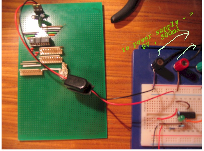

I found this post as i'm in the exact same situation. I already expected the higher voltage when unloaded, BUT...
I fed it to a 7805 regulating circuit and the 7805 got instantly roasting hot (and i presume shut off as is didnt power my PIC circuit).
Why is this? I thought even if it is spikey it would still only supply the current required by its load?
Is it that it puts out a constant power, and therefore if drawing a small current the voltage will be too high in compensation? <-- if so is that the difference between regulated and unregulated wall-warts?
It sounds like you've connected it wrong somewhere?, so it's unlikely it ever provided 5V to work your PIC circuit.

Ahhhhhhhhhhhhhh! ive just realised! Thanks for pointing that out! total schoolboy error from me. :oops:
See if u can spot what I did wrong:
(ignoring the circuit on the breadboard)
