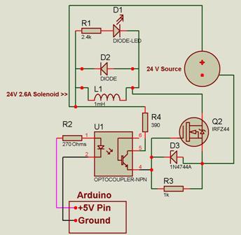

Mosfet Circuit check?
quant
Please check the attached circuit and advice the necessary corrections.
thanks in advance

Q2 will never turn on. You have provided two ways of grounding the gate, but have no way of pulling the gate high. Either move the gate resistor so that one is tied to +24V so that the opto-coupler can ground the gate, or vice-versa. 24V may be too high for the gate voltage of the FET, so you may have to add a resistor to create a voltage divider to limit the positive gate voltage.
Note also that the circuit provides an inversion. When the input to the optocoupler is high, Q2 will be off.
If you want non-inverting, then connect the opto transistor collector to the voltage and the opto transistor emitter to Q2's gate. As Mike noted, you may need a voltage divider to keep the voltage below the opto transistor's and Q2's max. voltage ratings.

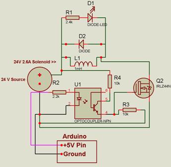

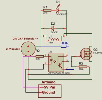

If you want the opto to turn Q2 on when there's a signal going into the opto, connect the collector (pin 5) to the + voltage supply and the emitter (pin 4) to the MOSFET gate. You'll need to use a voltage divider because the maximum Vgs of the IRLZ44N is 16V. See my attached changes--the existing R3 plus the new resistor will divide the gate voltage down to 1/2 the supply voltage (12V).

Thanks so much everybody and sorry for the mistakes...this is my very first circuit ever!
Will this do now??
cheers
edited:
slightly modified & R4 should read 15k!

Please confirm if R4 should be 15 or 100k???
I have doubts now due different opinions.
For slow speed operation 100k is fine. For faster operation the resistors may need to be smaller.
Will the transistor in U1 tolerate 24V?
Considering that there is a solenoid in the circuit, I doubt it's high-speed. 100K for both resistors should be fine. Even better, make R4 higher than R3, such as 150K.
But make sure the transistor in the opto can withstand 24V C-E.
Thank you so much crutschow & kpatz for helping me understand the function of the R's. I'll change them to 100 & 150k and try them out.
So far I am only using 12v but please recommend the correct type of Opto for 24 V?
So far on a proto board it's more or less...!
1-The voltage from the Arduino is about 5V but as soon as the Opto is plugged into the circuit, it drops to about 1.5v! Why?
2- However, the Opto is still working fine since on the other side of it utilizing a 12v for now, it shows about 12 with Opto inactive and when the Opto kicks in it drops to 12(source) - (1.5 from Arduino with Opto active) = 10.5!!! Why is the Arduino voltage being deducted from the 12v source?
3- The Mosfet is also functionin but sending just 1V to the solenoids!!!???
What am I doing wrong?
Each solenoid after Muliplexing will get to be on for just a couple of seconds every 15 minutes or so, but like every couple of seconds, a solenoid will get activated.
thanks
p.s.
the led doesn't function or maybe at .8v it just not showing? The solenoid does function with .8v but with no strength obviously.
p.s.s.
I am using a 10k and a 5k in series for the R4, that is not the problem or is it?
Are you measuring at the Arduino output or the optocoupler input? The LED in the opto will drop around 1.5-2V and the resistor will drop the rest. You should still see 5V if you measure between the Arduino output and ground. If not, the Arduino can't provide enough current to drive the opto.
Where are you measuring the voltage? Across the collector and emitter of the opto? Measure between the gate and source of the MOSFET, since this is the voltage you want. With 15K and 10K resistors and a 12V supply, you should see slightly below 4.8V at the gate with the opto turned on.
Once again, where are you measuring? Measure across the solenoid coil. If that's where you're seeing 1V, measure across the source and drain of the MOSFET. You should see a high voltage (near 12V) across the source/drain with the MOSFET off, and a low voltage (<1V) with it on.
Also, check your 12V supply to make sure it's producing enough current to power the solenoid. Also, make sure D2 isn't installed the wrong way. It's correct in the schematic (reverse biased) but if you install it the other way, it'll short out the solenoid coil, and probably overheat/blow the diode.
That's fine. Resistors in series add their resistances together.

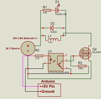

Anyhow, I found out the source of the problem, which was due utilizing an IRF Mosfet rather than an IRL! Well someone recommended to add a Zener Diode to the circuit which has helped.
1- I am using a 24 v power I am getting 0 to 14v across the solenoid, meter + probe to L1 left(facing) and - probe to the right L1. Why just 14 and not 24?
2- Arduino at the source is 5V.
3- Mosfet Gate & Source is 0 to 11V with the 24V supply? Why so low?
The zener is connected Cathod to U1 pin 4 & Anode to Mosfet's Source(pin #3).
thanks again for all your help.
Here's the final circuit:
Please note there has been some R changes too.
untitled-jpg.35219
You can increase both R3 and R4 (keep the ratio the same, more-or-less) to reduce the amount of current going through the divider, optocoupler and zener. For example, make R3 10K and R4 3.9K or 4.7K.
You should see approximately 17V at the MOSFET's gate the way the circuit is currently shown, provided that the opto's transistor is fully on. If your zener's breakdown voltage is less than 17V you'll see the zener's voltage at the MOSFET's gate instead of 17V. Whatever you do, you should make sure the gate sees at least 10V (but below the max of 20V) to ensure the FET turns fully on.
With the Zener in the circuit, you could eliminate R3 entirely, as the Zener will drop the voltage as needed. I would raise R4 to something higher like 10k though.
If you're still seeing voltage issues, when the Arduino has the solenoid ON, measure these voltages:
1. Voltage between drain and source of the MOSFET
2. Voltage between pins 5 and 4 of the optocoupler.
Both these voltages should be low (<1 volt) when the circuit is in the "on" mode. They should be high (17-24V) when the circuit is in the "off" mode.

Hi kpatz,
I took out R3 and changed R4 to 10k:
Mosgate = 15v
Drain to Source = 0 to 24(pretty good I guess?or Not?).
U1 pin 4 to 5 is about 3.5v.
please advice and again thank you very much for all your help.
cheers
p.s.
BTW, nothing heats up except obviously the solenoid itself.
trying to understand the zener
I am pretty new to electronics and trying to understand the purpose of the zener.
From the data sheet, if I am reading it correctly, this will only start to conduct at 15v?
With the 24v power source, will this keep the gate of the mosfet at 10volts or less? (I am not accounting for the voltage drops across the opto transistors.)
The Mosfet needs Min. 10V to work and I was told placing the Zener in the circuit will take care of the problem since it's gate was receiving only 5V before.
I am pretty new too and hope to have given you the correct info and hopefully kpatz could contribute here and explain the Zener issue more clearly for us.
