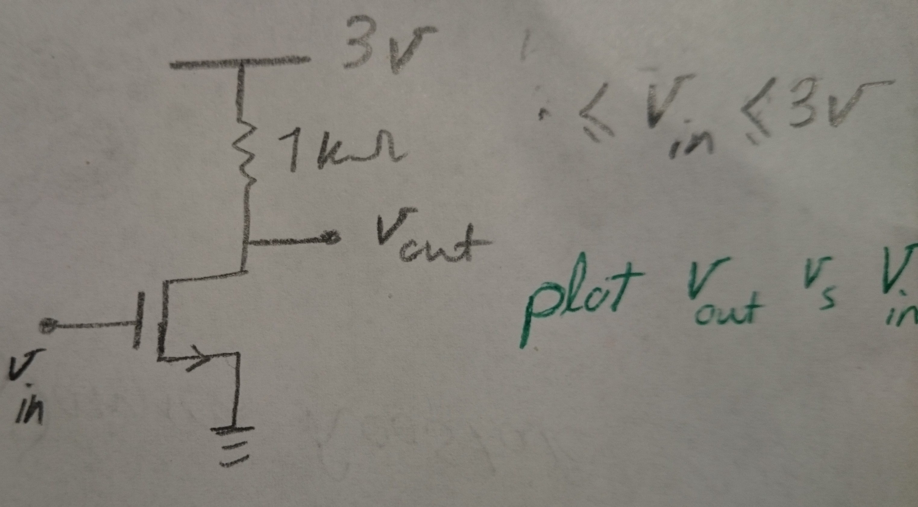

Can anyone tell me what is the plot of Vout vs Vin of this circuit? assuming Vth=0.5 v, I know before 0.5v the Vout would be zero but my question is that after Vin>0.5v the transistor goes to saturation region but I don't know until when it stays the saturation region?

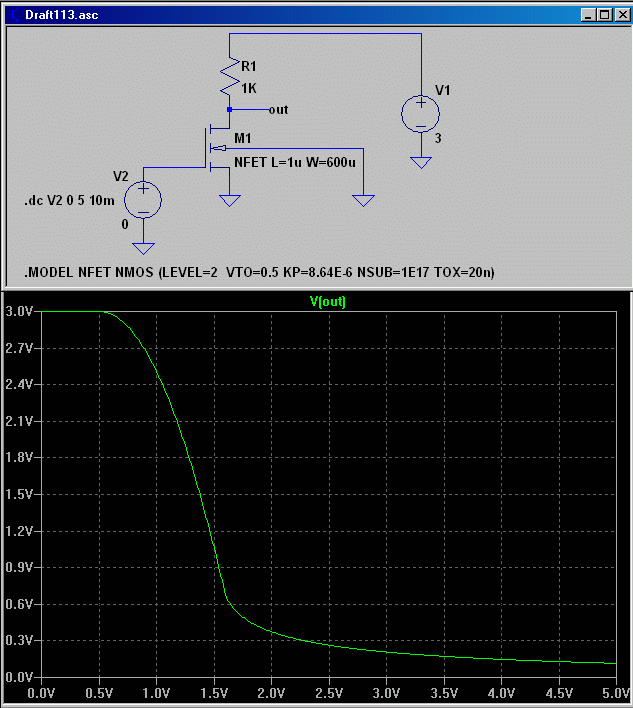

There are a whole bunch of things you would have to tell me about the subject transistor. **broken link removed** of the missing parameters. I had to make a huge transistor (W=600u) to enable it to sink the current sourced by a 1K resistor...

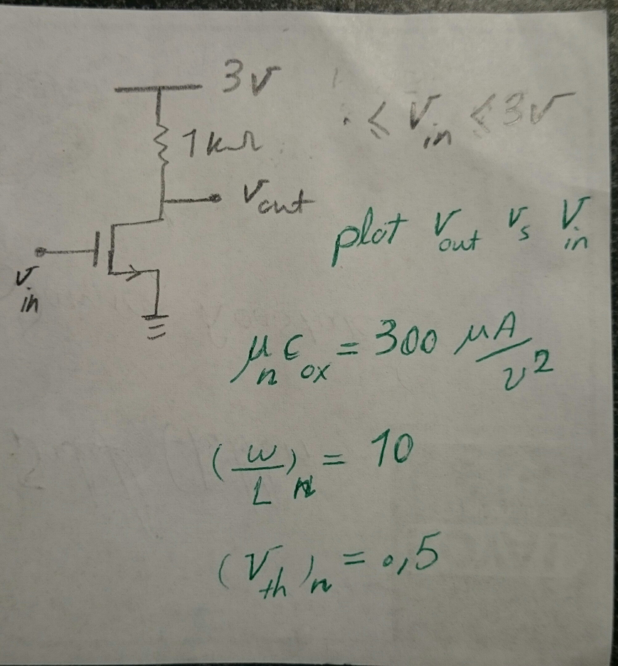

Attached is the updated circuit. That is the whole information that I got.

My main question is that after which value of Vin does the transistor go to liner region? Actually I am looking for the analysis of the circuit not the only plot!
