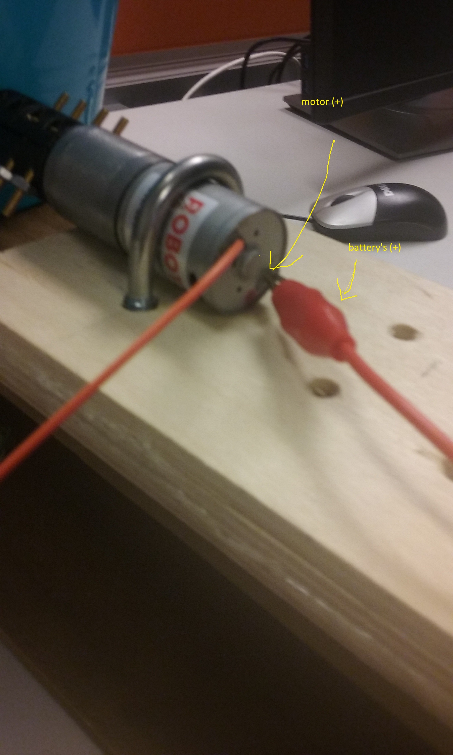

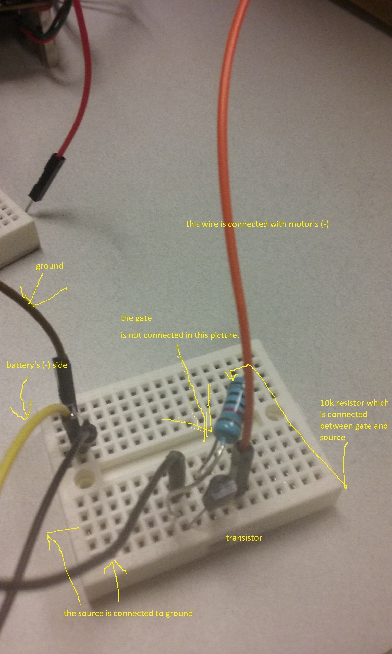

Thank you for the replies.
Here is my connection picture.
One more thing that I notice that when I connect ground on the gate,
Motor turns faster than when I connect voltage on the gate..

I just tested with a voltage supplier as a gate voltage (set it as 5v)
whenever I connect to the gate, the voltage supplier reads 11v (which is battery voltage) and motor doesn't turn on
when I connect ground from voltage supplier to the gate, it doesn't work.
but ARTIK board ground as a gate turns motor on.
You appear to have the mosfet leads identified correctly.
You can easily test a mosfet with a multi-meter set to ohms: https://www.utm.edu/staff/leeb/mostest.htm Frankly, I always found it kind of neat that you can discharge the gate with your body and watch the conductance decrease.
