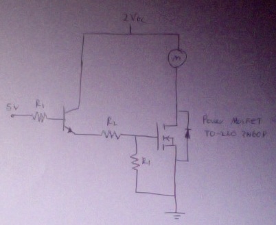

Hi I have a circuit (attached) with a 5v power supply operating a bjt allowing 12v to operate a MOSFET (TO-220 3N60P). The MOSFET completes the circuit for a motor running at 12v. The circuit may seem a little pointless, but its part of a larger circuit, and i thought this would simplify the issue. The reason im not running the mosfet at 5v is because at 12v the max drain source current is a LOT higher.

Using r1=470 ohms opens the bjt, however i cant find suitable values for r2 and r3 which open the mosfet. r3 is a pull down resistor allowing the mosfet to turn off again once power is cut to the gate pin.
Help would be appreciated, because I am quite stuck.
THANKYOU

sorry, now its attached.
the motor draws around 2A. Thats part of the reason why we need to run the mosfet at 12v, because it means higher drain source current

It looks like it takes 10 volts to fully turn on the MOSFET. It has a gate threashold voltage as high as 5.5v but at a Ids current of only 50ua so its more than 5.5 for sure.
10v to turn on MOSFET + voltage wasted in the voltage divider + 0.65v Vbe = much more than 5v is required at the base of the BJT to it turn on.
Use a logic level MOSFET and drive it direct from your 5 volts.
Buy a MOSFET driver IC.
Add a PNP BJT between the NPN and the MOSFET.
Drive the MOSFET off the collector of the NPN and invert your 5v logic signal into it.

I don't understand the emitter follower driving the Mosfet gate. The Mosfet needs at least 10V Vgs for good turn-on and you are only applying a few volts, which will barely start to turn on the Mosfet.
Also, that particular Mosfet is a poor choice. It has a high on-resistance of 2.9Ω max. which means its "on" voltage (even with Vgs=10V) can be as high as 5.8V with the 2A motor current, which will then dissipate 11.6W of power. You want a Mosfet with a much lower on-resistance, perhaps around 0.2Ω or less.

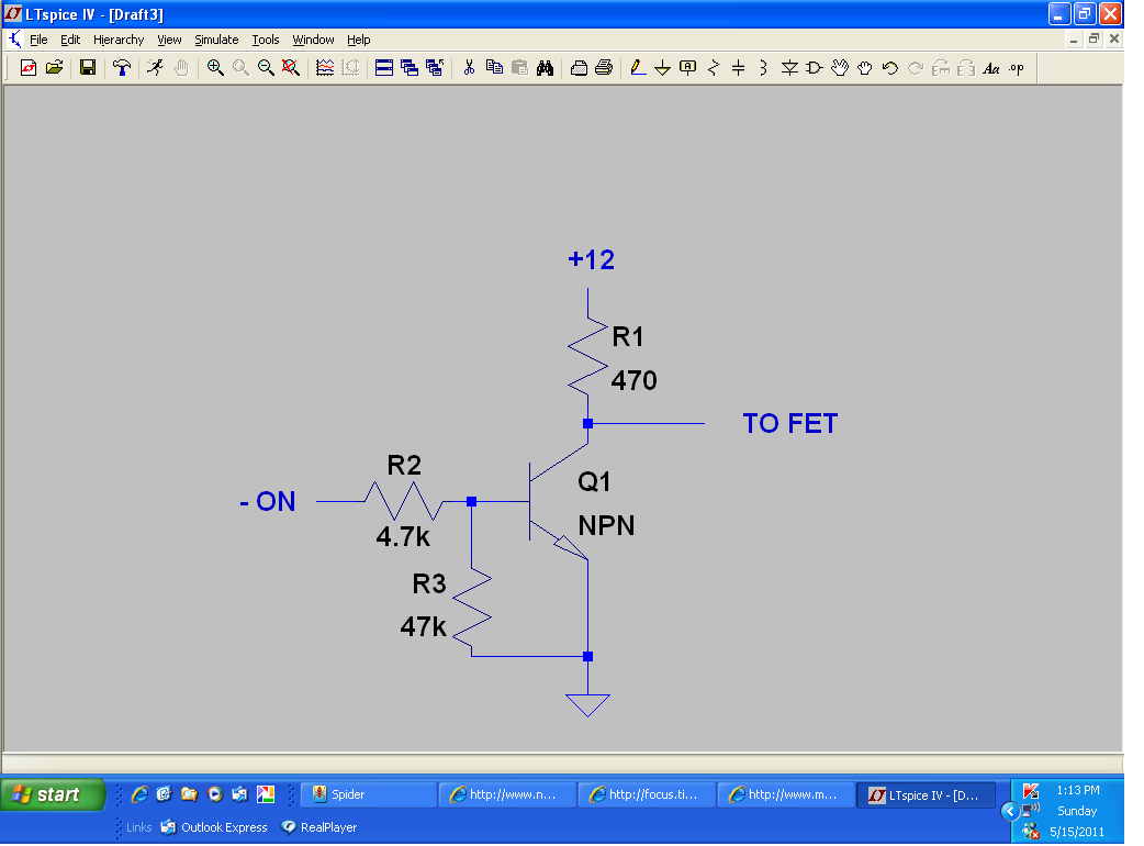

The transistor is configured as an emitter follower, so the emitter voltage will follow the base voltage minus the Vbe drop. Therefore you only have 4.3 volts to the gate of the FET. Change the transistor to a switch. This will invert your input so a 0 volt signal will turn on the FET instead of the +5. Don't know if that will work for you or not.
