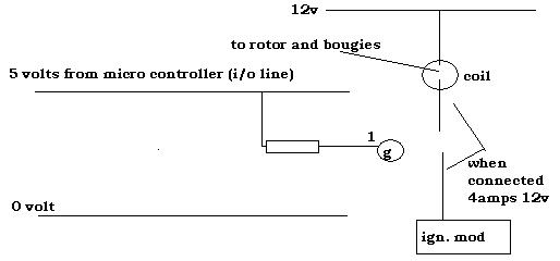

ok here we goo.>!!
to draw you a schemtic is a little use less because in words you could imagine the same.
the thing i want to switch is the negative side of a car bobine ''coil"
soow the + is conected to 12volts...and the negative is conected to different point and one of them is the ignition module.
when there can flow from the coil to the ignition module
some 4amps at highest..then the engine can run.
Whe are building a rpm limitter sow we want to cut of that cable.
nothing more nothing less (yes i know all the goods and bads about it..)
i have bought some BUZ11 es and i'm testing whit them.
the problem i had where that when i gave the gate a puls to conect them
the engine could run but when i turned of the pulse the engine kept on running....
in the image you see the sheme..
the hard thing is the thing i didn't finis.
because to switch whit 5volts i need a lover reference right..??
today i discoveret that i also need to ground the gate lin whit a resistance to the 0 line because else it keeps hanging...
well hope some body gives me the finishing touch
TKS
p.s. when conecting the bobine to ground directly there run 16amps.!!
and the engine don't run..!!!
p.s. maybe whit some high resistances between 0 and the mod line..???14K for reference.??

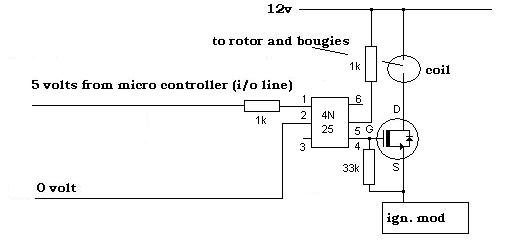

For safe working i recommend: drive the FET via optocoupler.

NOT working
after burned 2 mosfets...
it still don't work.
thirst i tried it with your sheme
but then the mosfet keeps the switch closed
and then it doesn't work anymore. :evil:
2nd i tried the gate to 0 with a 50K resistence but than
it worked (slowly) with my multimeter (bleep pos.) :twisted: :lol: :shock: :D
but when i connect it to the coil. it still don't work. When i supply the power, the engine runs; but when i cut of the power it keeps running.
(mosfet kapoet..!!! :lol: )
soow hope somebody can help me..
TKS
Do your mosfets have a diode between drain and source like in the drawing above? if it doesn't then the EMP of the coil when you turn it off may be what shorts your mosfet.
Place a diode yourself or get mosfets wich can handle inductive loads.
Diode in the mosfet
Yes,
there is a diode inegrated between Source and Drain (in that way)
S--->|-- D when i measure it it says 0,535 volt needed for the treshold..
i don't know nothing more, could you explain a bit more..??
They told me also something about a shotky diode on the coil..
From 0v -->|--12v but i don't know..

The place where you have inserted the FET is going to have BIG voltage spikes. a kilovolt would be no surprise. If the gate drive is referenced to ground, the FET will be destroyed at the first spark. Using a FET in the positive lead of the coil would work if you could arrange that the FET is only switched off when there is no current in the coil. This is one of the few instances where I am going to recommend a relay! A capacitor of about 0.22uf 1000v connected across the contacts will reduce sparking.

the ground kabel from the coil is the way that the spark module switches on the coil..
soow lets start where it begans thats by the rotor there is a small "hall gever" ( a kind of token giver) then the module conects the ground of the coil to ground and then come the spark in no time up..
soow the kabel we are switching is not thespark cable but the ground of the coil wich switches very often to ground per sec.
sow it is 6/12 volts.. ( the coil is in seri whit a 1ohm resistence (coil also has about 1ohm)
but about 4 to 6amps..!!!

Just an idea: if the wires of hall-element accessible, You can blocked it direct with opto.

IF the voltage across the coil primary doesnt exceed 12 volts THEN
1) A fat diode connected across the coil , cathode to positive, won't stop the engine
2) A neon lamp without a resistor , connected across the coil, won't light.
3) A FET, connected as you show, won't blow up.
I don't suppose you can get your hands on an oscilloscope to take a look?
I just don't like to see you blowing up all those FETs without learning anything. Why not try a relay? at least until the backfiring blows the muffler apart.
