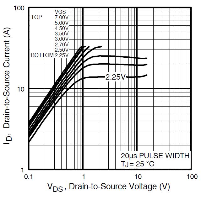

Please find the attached graph for MOSFET. I want to know if it is operated with a Vgs of 3.5V , then can we keep the Vds to 5V ? . In the graph the Vgs of 3V shows a Vds of merely 1.5V what does this means.....

Keep in mind that the drain current at the point you specified is about 35 amps. That's a power dissipation of
P=1.5V*35A=52.5W. If you raise Vds to 5V, the dissipation will be at least 175W. Even in the first case, you will have problems keeping it cool unless the current is low duty cycle.

The graphs of the datasheet are for a "typical" mosfet.
But you cannot buy a typical one, you get whatever is available. It migh be much worse or much better.

I will draw according to the package , What I need to know is , is the graph incomplete(or not necessary) for Vgs above 2.7V which dosent shows saturation.

I am just switching a 5V/2A load(or less) with Vgs of 3.3V, the mosfet make is Irlml2502 .
Your Mosfet is a tiny little thing. With a Vgs of only 3.3V then a load of only 2A might be fine.
It is guaranteed to conduct 3.6A with a Vgs of 2.5V for 5 seconds when its junction is cooled to 25 degrees C somehow.
But it might get so hot that it desolders itself.
You don't need that graph. All you need is the attached spec. The max Rds(on) is 80mΩ, and that is with Vgs=2.5V. With Vgs=3.3V, your Rds will be less than 80mΩ.
Pdiss<.08Ω*2A
Pdiss<160mW.
The transistor will barely get warm.

I can't see anything that guarantees it will work at Vgs of 3.3 volts. But, from your curve we know that Vds will be below 0.1 volts at 2 amps and 3.3 volts gate to source so the power will be less that .2 watts, so temperature less than 20C above ambient.

Please have a look at datasheet p.4 Maximum SOA , It dosent shows DC line !! . If I switch 5V@2A continuously will that be a problem .

I need to operate it continuous mode . Not with PWM or switching. If my load is say 2A and Volts 5A , then the MOSFET has to bear 10W continuously . I am not sure regarding this, probably designing a Load switch .
I need to operate it continuous mode . Not with PWM or switching. If my load is say 2A and Volts 5V , then the MOSFET has to bear 10W continuously.
NO.
The power supply provides 10W. The Mosfet dissipates (2A*2A*.08Ω = 320mW and the load dissipates (10W - 320mW=) 9.68W.

You will never have 5V across the transistor when it is on, because your Ids is only 2A, and Rds(on)<.08Ω. Vds will be less than 160mV. As you correctly calculated, Pdiss<320mW. With RθJA<100°C/W, the junction temperature rise will be less than 32°C above the temperature of the PC board.

Thanks , its clear . Regards
