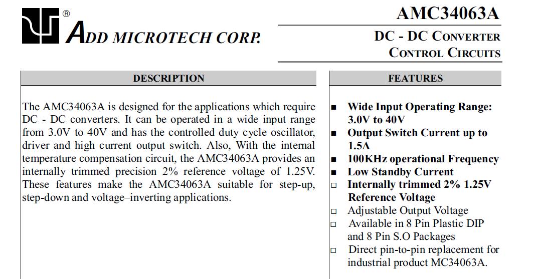

8 parallel sets of 10. You need 6v or 9v supply. Use a converter chip out of a car phone charger for $2.00 from a $2.00 shop. Your micro can give you PWM and flashing to reduce the current. Use 8 transistors to switch each string.
80 leds at 20mA = 1.6 amps / 4 = 25 % on time = 400mA converter chip out of a car phone charger good for about 1amp But you can boost with them to so you use 4 alkaline AA cells you'll still run out of power fast and them converter chip from a car phone charger waste about 20% of the power.
What part? The number 1 chip used in a car charger AMC34063 nice chip

Ok here is my thoughts. Use LIPO batteries but in parallel to get more Ah , use the MC34063A like i said to boost the power then to charge the LIPO use the MCP73811 or better the MCP73812
