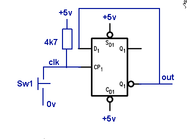

As for the wave-on, wave-off, you will need a circuit like this one, connected to the sensor circuit:
I believe that if you replace SW1 with a bipolar transistor (collector to "clk" and emitter to "0v"), the base can be connected to the output of the sensor circuit. This way, it will turn on when it receives a signal (a wave) and turn off when it receives another signal (a second wave).

EDIT: I believe you will actually need a PNP transistor for this part of the circuit, so that it can be triggered by the 393. I this case, you will need to connect the emitter to "clk" and the collector to "0v".

A quick note: I think this schematic is mislabeled, namely at the very bottom it says +5v. I don't think this is right. Though I could be wrong, I think that should be 0v (ground).

Here's the schematic I have right now:
View attachment wave-on_wave-off.sch
I'm hoping I have the pin numbers on the 7474 right, but if I don't, I'm sure someone will let me know ;)
