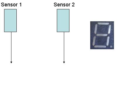

Hi guys i need to build a simple motion detector counter shown in a 7 segment. The two sensor will be place together at the entrance to count people, if someone pass through sensor1 it will increment 1 and shown on the 7seg, where else if that guy leaves the room(through sensor2 first) it will decrement. Anyone got the circuit diagram? Sorry i'm new to engineering, i can only explain this far.
X Y Z
0 0 Nothing happen
0 1 Decrement
1 0 Increment
1 1 Nothing happen

One possibility would be to use an up/down counter like the 4510. You would need to do two things, (1) generate a single clock pulse from each sensor, and (2), based on which sensor is generating the clock, use this signal to set the 4510 to either count up or down.
Have a search for "up down counter" here and in google.
One link: **broken link removed**
