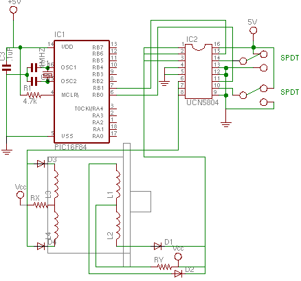

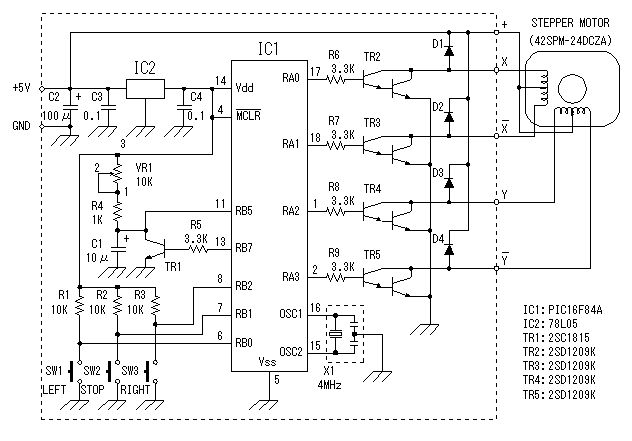

I find 2 schemes for the circuit, what do you think about it?Which is better on your opinion?
Nigel Goodwin said:
Personally I'd use the one with the transistors, there's no need for a driver IC, it's simple to perform the stepping in the PIC.
Thank you for advice. Best wishes.
