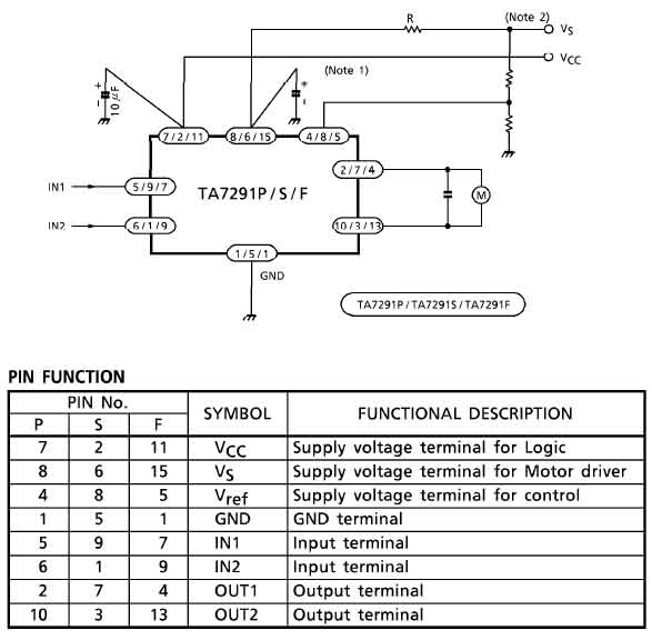

I am working on a h-bridge motor controller, driven from a uC. the uC sends two lines for direction and has a PWM output. now, i have the controller running for what i need, but i need a good h-bridge, i have a few ta72915 SIP bridge drivers, depending on how easily i can find more, these may be what i use in my final design, if not, it will be something close. but for now, i will be using this chip just because i have it. basically i need to know, how i run this PWM'ed. ie. where dose my PWM line from my uC go? i have included 2 screen shots from the data sheet, the pin descriptions, and the sample circuit.

Usually its just the PWM IN1/2 pins [2] to the H-Bridge inputs as per your dwg.

what do you mean by that? i just have two control lines going from uC to h-bridge. 10= cw 01= ccw. to add PWM i need to take my PWM output and connect it somehow to the motor driver. i am happy to give you as much info as you need. anything else?

Basically you drive the IN1/2 pins with the PWM drive, this can give speed and direction control.
Why would you need 2 pins for direction only.? :)

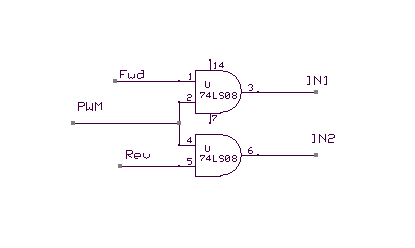

i am sorry, i am using hardware PWM. i need direction only pins and PWM separate.
I would think in that case, extra logic gates, say 2 off, two input AND gates would enable you to choose direction and PWM.

Something like this.

yes i do follow, but your saying that there is no separate input for some sort of reference or PWM on the controller? than can you think of any way to keep component count down and still use hardware PWM?

As you want to keep the component count down, is it possible to rework your PIC program so that you can drive both the IN1/2 with PWM.?

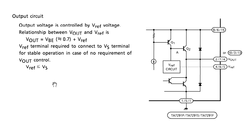

no it is not posable to do that with hardware, and i need all the software room i can get. cant the PWM go to the Vref input?

never mind i answered my own question. if i am driving the motor @5v i can just send PWM to Vref. if higher voltage is needed i can just run PWM through a current limiting resistor to the base of a transistor to switch a higher voltage.

The Vref is used to set the motor voltage, if not used its connected to the +Vsupply.
