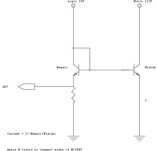

I'll draw a schematic in a bit...this is too wordy.
Schematic
Here we go. The concept is that the diode-connected transistor (like how the left transistor has those 2 terminals connected) will mirror the current on the other branch. It does not have be mirrored exactly though- the current in left branch will be a multiplied by a factor of the current in the right branch. This factor is the ratio of the widths of the two transistors.
Left width < Right width -> lefthand current smaller than righthand current by a factor of (Left Width/Right Width)
Left width > Right width -> lefthand current is larger than righthand current by a factor of (Left Width/Right Width)
Left width = Right width -> same current in both branches
Hence,
I_left = I_right*(W_left/W_right)
Its the simplest form of a current mirror.
Seeing as how this is not VLSI design (we aren't designing the transistors on a chip, and therefore have no control over their widths, you may have to hunt around spec sheets to find the width or try different transistors until the current is stepped down enough to be read into an MCU ADC.
I have never used a current mirror with a motor like this yet, so tell me if you try it and how it works!

Don't try it. You'll never get enough gate drive to switch the power MOSFET on hard enough to drive a motor unless you drop at least several volts across the resistor, and then you won't have a predictable current mirror. Besides, a current source is not a good match for a motor. For good torque, you need a low resistance source.
The whole idea of current sensing is to sense the current, not to force it. Your circuit forces current. A motor needs to be driven by a voltage source, and the current varies with load on the shaft.
Test
Am I missing something? The gates are connected to +5V aren't they? Shouldn't that put Vgs to be large enough for both transistors to be in saturation? (Or am I mixing up the operation modes of a MOSFET)?
I am starting to think the diode-connected MOSFET should be the right MOSFET instead of the left MOSFET. After going over some notes I think that the right branch is mirroring the left branch (instead of the left branch mirroring the right branch).
BTW I mean for the transistors to be MOSFETs (not BJTs) but was too lazy to look for them in the symbol library.

Well, I do have to confess that I didn't notice you had connected the gate to +5V. I guess I was assuming it was connected to a current source. However, I don't think you could find a MOSFET that can handle that operating point. For example, a 2N7000 would be typically drawing 800mA and dissipating 4 watts, for a few milliseconds. After that, it would smoke, and then slowly cool off. :(
Besides, all my other points still stand.

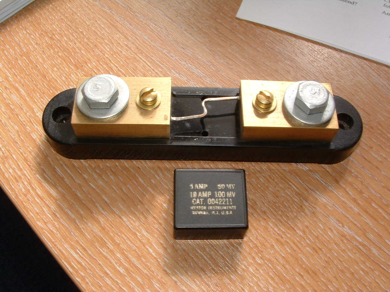

As suggested by Styx, use a low value resistor and measure the voltage across it.
If you use a 0.1 ohm resistor, when 5 amps flows through it, the will be 0.5 volts across the resistor.
If your motor cant stand the loss of 0.5v, use a lower value resistor to get less volt drop, but then you have to amplify it a bit more before feeding the ADC.
See the attached picture of a 10Amp 100mV current shunt.
How would I hook up the shunt resistor then? In series with the supply voltage? Do I have it on the high side or low side? Then do I use an opamp to compare the voltage on each side of the resistor, amplify it, n feed into the PIC ADC? I don't have a software to make a schematic of what I mean......sorry......
