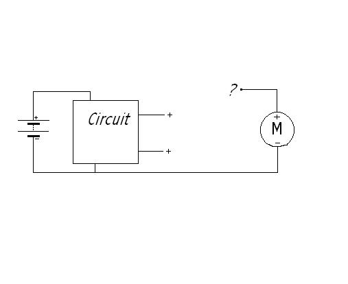

Im trying to build this simple project that requires a motor to rotate both ways.I know that to do that you would have to reverse the polarity to the motor(if thats how you say it).I only have one Battery connected to a circuit that switches two outputs on and off.
:?: Is there anyway to connect these two +V outputs to the motor so as to result in forwards and backwards.Check out the diagram below.

create a H-bridge out of MOSFETS
that way you can reverse teh polarity of the voltage (and thus the direction) and if you want to be really cleaver (you know you wanna) you can vary teh PWM feeding the switches and thus the average voltage going to the machine thus the speed can be changed

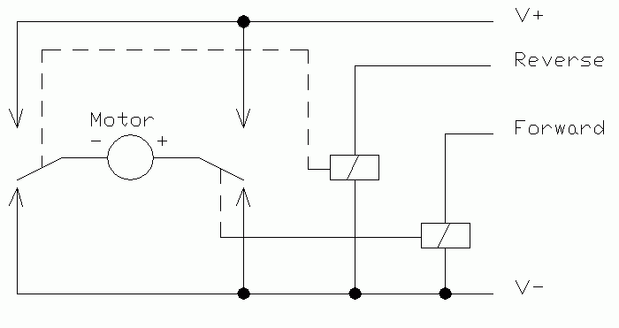

To change direction of a DC motor you must use bridge
type connection that allows polarity change.
The full bridge ("H bridge") is required for single power supply
while half bridge would do if you use dual power supply.
Since nobody likes to use dual power supply let's see the
full bridge example.
This can be done using relays as shown or making an
electronic version with transistors (there are specialized chips
for this of course). The advantage of electronic version is
faster switching time which is used to regulate the motor
speed by controling duty cycle (pulse width modulation).

Wow,Thats brilliant.Just read up about the H bridge and its perfect for what I need.
Its nice to know that theres an IC (L293) that does it all for you but I think I'd prefer to make the H bridge using transistors.That way I'll learn allot more.
Thanks guys for all your help,much appreciated. :D

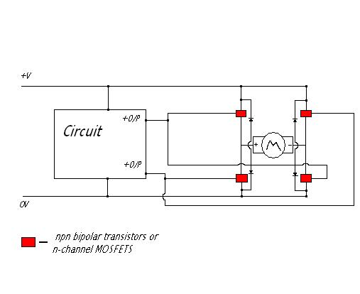

My circuit can only have one output at a time but it may change from one to the other in a few seconds,is that enough time to allow the transistors to switch off.Below is the circuit layout I want to build but I was wondering if it was possible to use all npn transistors or all n-channel MOSFETS.Cause surely the transistors act as a relay when they are saturated.
Also Im not too sure if the diodes should connect to the + and - of the motor,whereas they pass over it in the diagram ?
Sorry if the diagram is poor but I had to use paint. :lol:

good that you appreaciate the problems of shoot-through

as to using all N-tpye devices you can but you will need to provide a isolated supply to drive teh top two FET's since if you look at it as the drive is switching you will be passing current into teh motor winding the source voltage of teh upper FET's will be jumping around thus you cannot ensure that you will be saturating the FET's
either using a floating/isolated supply for the top two, or if your link voltage is low enough w.r.t. your control votages use P-types
as to your diode question. All diodes MUST be facing up in your present arrancement ie the cathodes all pointing to teh +ve rail
Ah right, I drew the diodes the wrong way.Yip so they all face upwards.
I think I'll just stick to using p channel MOSFET's for the top two transistors.
