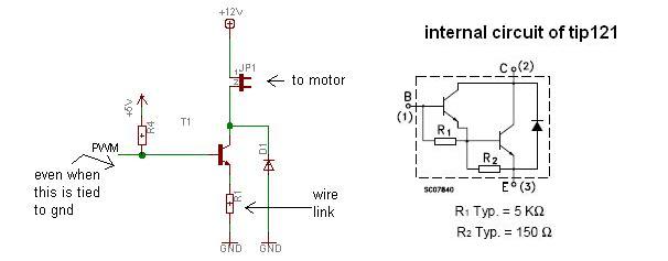

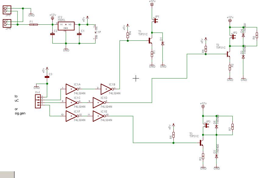

Im working on a line following robot for Uni. We've built a PCB for our motor driver which we tested and was working fine. Ive added the full schematic (and another pic with one drive circuit and internal circuit of TIP121).
We tried it again this afternoon and something went wrong:
As soon as we connect power to the board the motor starts full power, as if there is something shorting out the transistor. It is the same for all 3.
One time the transistor got extremely hot, so maybe it has been destroyed? ALthough I thought that would make it open circuit, and the motor wouldnt work at all?
It blew a couple of 5A fuses aswell.
I cant figure it out at all, I had a long hard look at the board to see if i could spot anything but couldnt, but i was pretty stressed by then cos we were supposed to demonstrate it this afternoon.
Can anyone help?
Thanks,
Michael.
PS. R1,2,3 are wire links, R7,8 are open circuit, and its the TIP121 not the tip31 like the schematic.

THe motor starts even when there is a base-pull down resistor? I'm not suprised ot starts full power when you have a pull-up resistor on the NPN's base.

By far the most common failure mode for power transistors (either bipolar or FET) is for them to go short circuit, going O/C would be extremely rare.
D4 and D5 protect the transistors T2 and T3 from the inductive voltage spike from the motors. T1 doesn't have a protection diode so maybe it fails first and causes the others to fail.
Diodes D1, D2, D3 and the diodes in the darlingtons don't do anything in your circuit.

What is the output stage for HCT logic, im trying to figure out if thats something to do with transistors blowing.
The max allowed output current of 74HCxx logic is 25mA. It will try to drive 60mA or more into the transistors or darlingtons and will blow without a series current-limiting resistor.
The logic high current of an old 74LSxx IC is not much but it still might blow up when directly driving a transistor without a series current-limiting resistor.

Your original schematic shows 74LS04 TTL inverters driving a weak output high current therefore requiring the output pullup resistors.
Then you changed the IC to a 74HCT04 which has the same compementary high current Mosfet outputs as a 74HC04 and a warning not to exceed 25Ma. They can provide 60mA at the output for a moment to quickly charge wiring capacitance for high speed. A resistor must be added to their outputs to limit the current to 25mA or less.
Maybe you can use darlington output transistors with the series base resistors built-in.

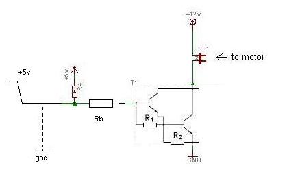

If I just go back to an LS chip will that work without a base resistor? I think they may be hard to get though.
I might just cut the track and botch in a base resistor. Would that work with either logic chip, and with the pull-up still there?
For the base resistor:
If the gain is 1000, and my motor current is say 0.7A, i should make Ib at least 0.7mA to saturate. Is that all?
if say the output from the inverter is 5v and i want my Ib to be 5mA, then my resistor should be
R = (5-1.3)/5mA = 740.
Or if i use 470R: Ib = 7.87mA.
and if inverter output is lower, say 3.8v: Ib = (3.8-1.3)/470 = 5.32mA.
concl. : 470 ohm.
Is there anything wrong with these calculations/estimations?

The output voltage of an inverter is not 5V unless it is Cmos without a load.
An old TTL output high has a low current and goes up to about +3.5V without a load.
A 74HCxx output can drive a 150 ohm resistor in series with the base of the darlington and a pullup resistor is not required.
Darlington transistors amplify well with a gain of 1000. The datasheets show that they saturate well if you allow enough base current so it is 1/250th of the load current.

The store at Uni only stock HCTs.I cut the track and stuck in a base resistor to give about 5mA and removed the pull-ups. It seems to work now but it blew another inverter chip first. Hopefully it doesnt do it again.
Cheers,
Mick.
The inverter chip and maybe also the darlington transistor will continue to blow if you don't add a reverse-biased diode across the motor to arrest the very high voltage created by its inductance when it is turned off.
The 74HC inverter is rated for a max output curremt of 25mA. With only 5mA into the base of a darlington transistor then it will satuate well with a max load current of only 1.25A. With a 20mA base current then it can drive 5A well.
