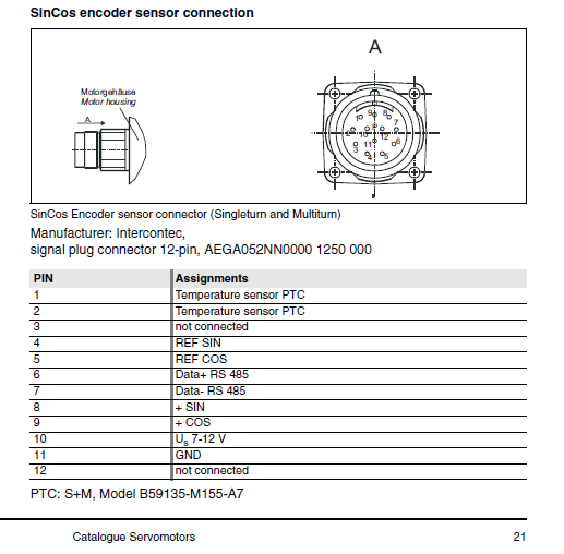

According to the data sheet, the single-turn encoder also has a REF+ & REF- output.
Those should be the zero reference.

I guess you looked at the wrong point in the datasheet. REF + and REF- are given in table valid for resolver (page 22). For SinCos encoder, it is specified as REF SIN and REF COS in the table (page 21). i don't know what they are Do you think it contains index information?
I have just try to scope to refcos and ref sin. Ref sin connection is bad so i didnt scope it. But i can scope refcos pin of the sincos encoder.
Its a constant 2.88v. Its not depended to turn or agnle of the shaft. Its just a 2.88 v on every position.
So there is no index i guess :(
What should i do now ?
Isn't zero degrees when sine=0 and cos=max?
no this is sincos encoder not resolver. In a round, 1024 times sin is max, while cos is zero. or vice versa.
Sorry, you are correct - I was in a rush and trying to answer before going out..
The encoder you have is a hybrid digital one.
The drive is supposed to use the digital comms channel to read the absolute position of the motor at power-up, and then it can use the sine & cosine signals to track the rotation.
The sine & cosine are two sets of differential signals. They should each connect to a terminating resistor, eg. 150 ohms (between signal and refsignal) then go in to a differential amp to extract the positive or negative difference output.
The difference voltage from each channel is the true analog sine signal.
If you only want to count cycles rather than interpolate within each cycle, you could just use differential line receivers with terminating resistors, to produce logic level quadrature signals.
