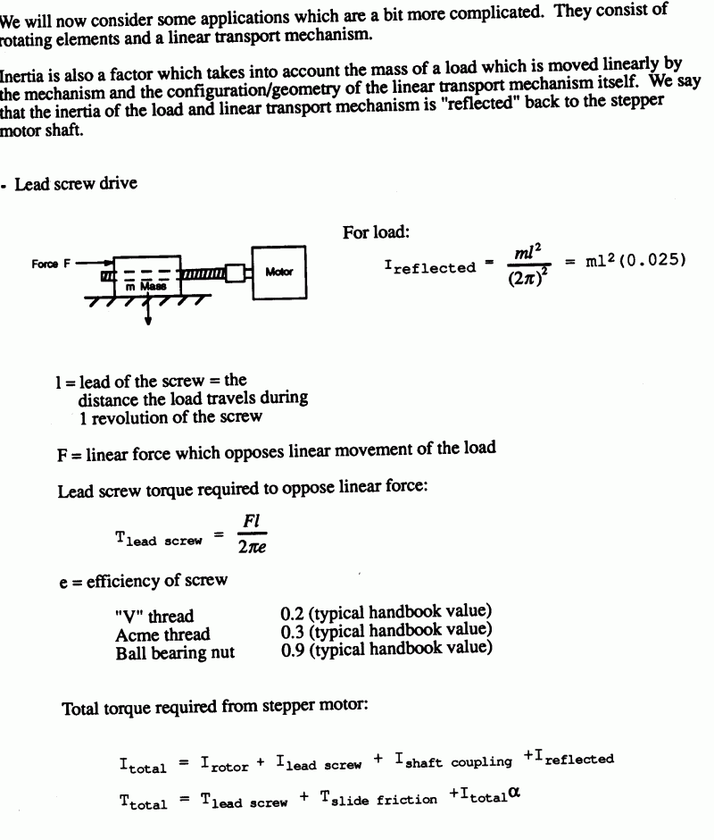

Hi Watzman,
below is a page I scanned out of a book called easy steppin. It gives you a couple of formula's to work out torque and motor requriements hope it's of some help.
Cheers Bryan :D

A lead screw, 2.5m long is not exactly a "small" device, in fact I would say its rather large. Have you thought out the mechanical details to support it adequatly? The other thing, have you studied stepper motor driving systems? Its not just a simple matter of turning a switch on or off to make it go. You have to 'ramp up' the steps for the shaft to gather speed and then to 'ramp down' to stop it.
Then you have to consider the 'backlash' of the travelling nut on the screw and allow for it too. Circulating ball screws would be nice to eliminate the backlash, but I think at the size you are talking about the expense of such is rather large.
If, as required with CNC, you wish to do that with any accuracy, you need a good driving board.
How did you measure the 50kg load? Is it what you put on the table or is it the load you must apply to the lead screw ( at a certain leverage) to make the load move? There is a difference, if its the latter you can work out if the torque of your motor matches the torque on the lead screw.
Keep in mind that there will be extra loads if you do any machining while the lead screws rotate - as is usual with CNC machinery.
