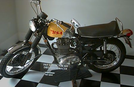

If the bike needs to be street legal it won't work - headlights on trail bikes (and many smaller motor bikes) commonly have the headlamps fed direct from the flywheel alternator - this results in the lights seriously dimming as you slow down (you would need a hell of a big capacitor to try and stop that!). The indicators and brake lights are usually fed from a smallish lead acid battery, which is charged from the alternator - as you slow down (and charging current disappears) the battery takes over feeding your indicators and brake light.
For an indication of capacitor size use the formula C=IT, so assuming a 10amp headlamp bulb, and 10 seconds of capacity - that means a 100 FARAD capacitor - big beast!.
If you wire it as normal, using a standard motorcycle battery, it won't affect starting at all even if the battery is totally flat - it will simply start charging as soon as you start the engine.
Perhaps Russlk would let us know what the capacitor did on his BSA (sorry, but I don't recognise the model) - presumably it was only to power the ignition?. One device I do remember on various British bikes (not sure if it was BSA or Triumph) was a large zener diode on a heatsink just below the headlamp - this was to prevent the battery getting overcharged at high revs.
This is from:
https://www.allenmuseum.com/bsa441.htm
it says dirt track racer,
but this version looks street legal to me.
They may have also been known as 'Shooting star'
i think.
Maybe that was the name for the street version.
The generators on some of these dirt bikes had
permanent magnet fields, so voltage control
was by excess power sinking (wasting) using
fairly meaty zener units.
Simple but effective, although they were prone
to failures from overheating damaging the
wires and connections close to the unit.
(at least the ones i met were, but then i didn't
usually get to meet them till there was a failure)
John
