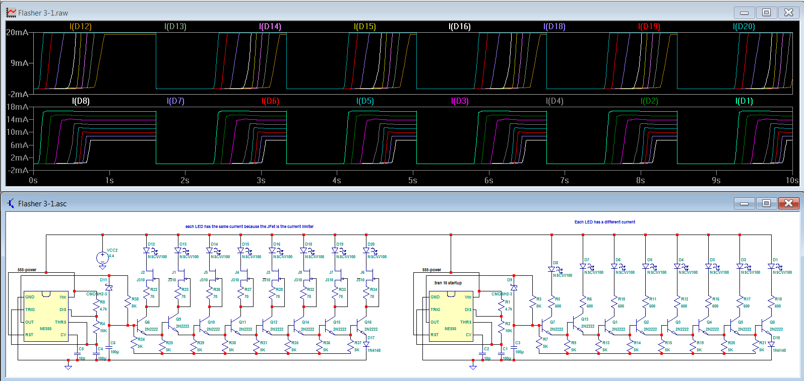

Here's a sequential flasher from days gone by
  • Flasher 3-1.asc

That .asc file that Kinarfi posted can be opened it LTspice a free program from Linear technology used to simulate circuits.
Kinarfi, do you have a .jpg or pdf to post as well?

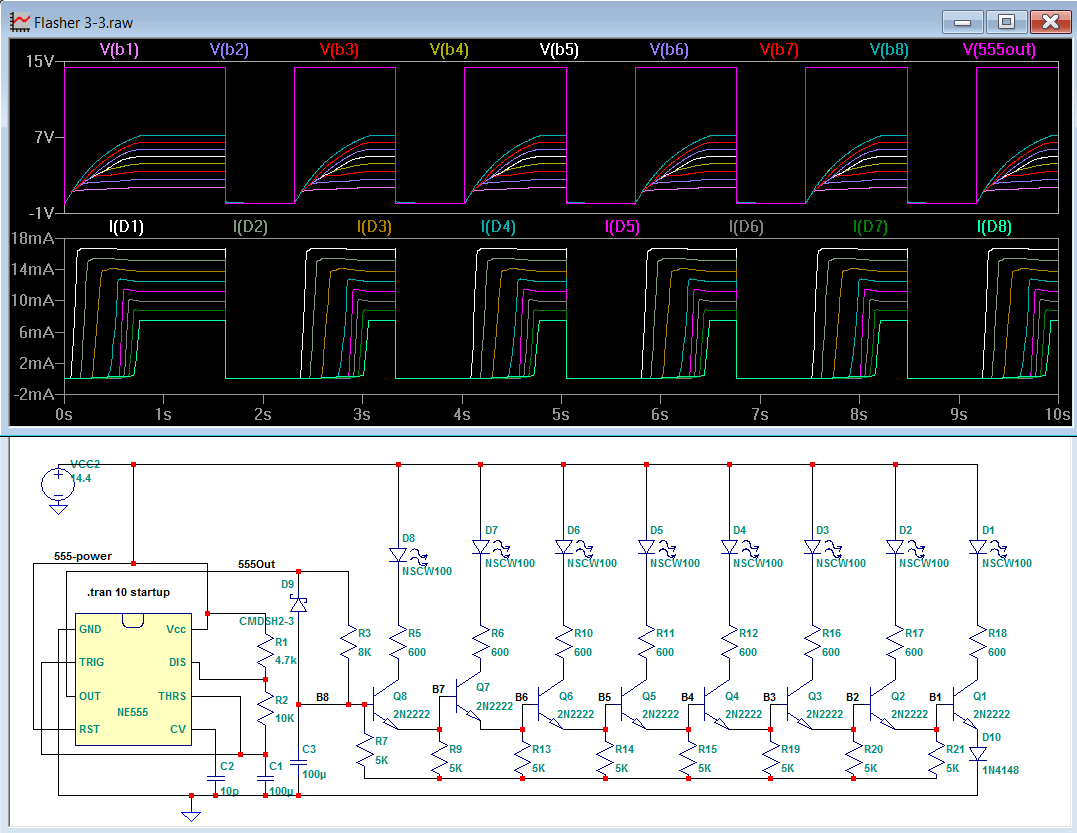

This is actually 2 circuits, one voltage source, the voltage to each LED drops as you move from right to left, so each limit resistor would need to different or the brightness would change. To take care of this, I used a current reduction device/circuit, CRD, to keep the current through each LED equal, made up of a JFET and a resistor.

That surprises me, may I suggest you get it, it's so very handy IMHO, so here's the schematic with the current of the LEDs and voltage of the bases. In response to your #8 post, the way this works is the 555 has a period of ~1.5 second and as the voltage on C3 increases, it turns on Q1 thru Q8 sequentially.
