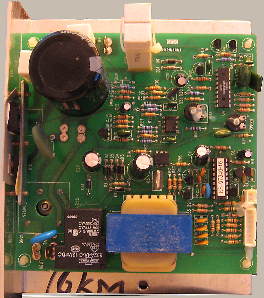

I'm trying to repair a Motorized Treadmill of a friend that starts and runs for about a second then loses strength, stops and gives an E1 or E2 message mostly E1.
there's somekind of sensor next to the weel of the motor that i didn't realy test disconecting before i unasembled the board, no ideia if this could be the problem.
i'm guessing the problem is in a big fat 400v560µF(M) rubycon capacitor, but again i'm realy guessin here can anyone give me some tips on how to find the problem or maybe support my theory :)
any help would be nice, ah and no luck with the support team from the seller...
by the way first post, hello everyone.

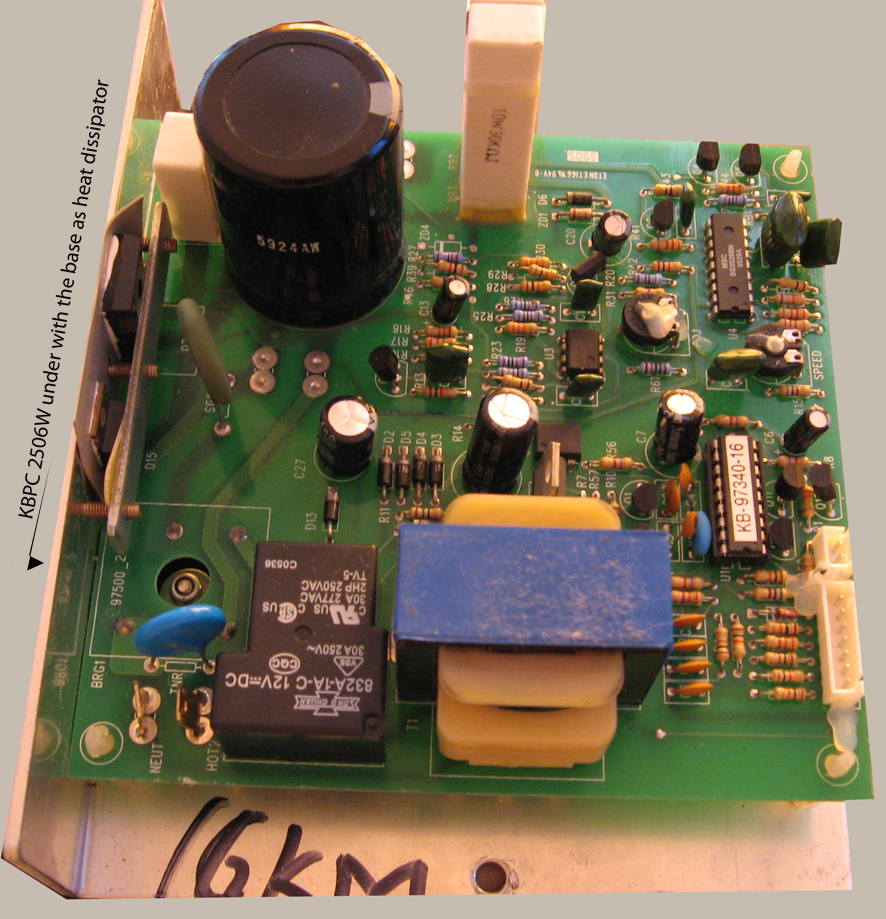

2 images of the main bord are attached

Unlikely to be that large filter capacitor you mention. That sensor next to the motor's pulley is either a reed switch or coil. Look for a small magnet on the motor's pulley. The purpose for those is to count rpms which is then transposed to mph/kph respectively. The magnet may have fell off the pulley thereby setting the error code. As already mentioned, try to find out the error code meaning(s). You also didn't provide us with the brand and model number -- that sometimes helps, ya know!

Your PWM Control Brd there may not be a top of the line motor controller, but it does appear to be of better quality then some of the cheaper treadmills I’ve worked on and repaired.
I need a few bits of info from you, as I may be able to get a calibration and/or T/S guide for you with the T/S Error Codes.
To answer a few ?’s you had asked.
The most probable failed board component I’ll address further below, as it’s quite common with most treadmills. The motors rarely go bad except for the normal brush wear. You’d have to be using the treadmill 24/7 for 5-6 years straight to even get close to wearing out a set of motor brushes, or a motor drive belt. That is - unless it’s a really cheaply made treadmill.
Your VCO (Tach pulse) reference coil pickup should be OK unless someone actually tried to reposition it, or it somehow came loose. They never seem to go bad, as all they are is a pulse coil feedback device that sends a reference pulse signal to the VCO circuit. It’s usually tightened in place with a nylon type clamp, and the gap should be roughly 3/16” to 1/4” MAX. It’s not super critical, but yet it has to be close. There are usually 2 magnetic reference points 180 degrees apart on the drum wheel as well.

Can you also take & post another pix of that PWM control brd facing from the other side where the 3 bigger ceramic sand stone power resistors are located. That large filter cap may even be hiding a 4th power resistor - not sure as I can’t see through that cap.
Btw - that large filter cap is not your problem. I’ve never had one go bad yet!
What is the R value & wattage rating of R82? It is sitting right next to R83 (the 30K 10 watt power resistor)?
Also - what is the R value & wattage rating of that 3rd power resistor to the left of that main filter cap in the pix you posted?
I’ll also need the p/n’s off the D15 Diac, and what is usually the SCR in ? next to it - mounted on the heatsink plane. What is the board reference part # as well for the SCR? The Bridge Rectifier sure is mounted weird on this PWM board you have there. Usually everything POWER DEVICE wise is mounted on the back-plane heatsink, but it looks like they even skimped on that part on your board there.

dear esphix can you please tell me the value of the green capacitor beside the big fatty capacitor 560uf , or if you have the circuit diagram of this board i would be so thankful if you sent to my email [Mod: Deleted email], this capacitor which make a problem similar to yours when started it remains silence for 1 sec then motor come very fast and give e1 or e3 then i figured out that this capacitor is burned and i can read the pico farad on it , also check the carbon rods if some wear on them just change them because they affect the starting time which also gives e1
