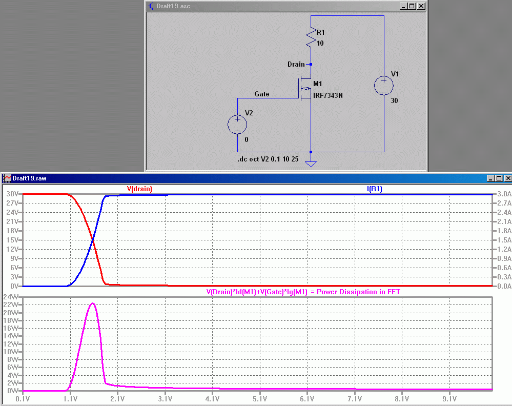

Here is a plot of FET power dissipation vs gate voltage for a specific example. Note that as the gate is driven harder, the dissipation comes down, but not dramatically.

Mikes sim shows the various regions. Just left of 1.1V is the cut-off region. Between the 1.1v and about 1.8v is the ohmic region (for his particular current flow) and everything to the right of that is the saturation region.
Notice however, that dissipation comes down dramatically when you enter the ohmic region. BTW, how do you get the plot for the product of quantities. Help out a LTSpice noob. :)

From the standpoint the FET, I was trying to show that once you get to Vgs>than about 2Vt, there is not a huge reduction in power dissipation.

You are correct in that it would take an extremely high voltage to go from cut-off directly to saturation. But you never go directly there; you have to go through the ohmic region first. While this transition is happening, you are starting to get some Id flowing, which will reduce the Vds voltage drop. This is then going to require less of an increase in Vgs to reduce Rds even further, and also why the Vgs to Rds graphs are curves.
