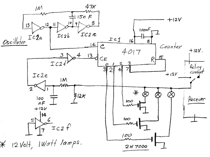

We want a device that will do the following... contain some type of sensor that senses an approaching vehicle like a traffic counter tube or a garage door sensor type device. Then when an approaching vehicle is sensed the device randomly selects one of three green lights on a post to illuminate.
The purpose is to force the driver to make a split second lane change in order to enter the section of the course indicated by the green light.
I have built small electronic projects before but always from kits, never from scratch. I humbly ask for direction what parts I should be looking for and where. I appreciate all advice.
Ideally it would be weather proof and battery powered.
I have located a viable vehicle sensor that will output 12 volts DC. Now I just need to use that 12 volts to randonly illuniate one of three lights. Please help.

There are many ways that it could be done. You could use a PIC, or do it in hardware.
A simple way to generate a random number is to have a counter running continuously and, the counter is stopped when a button is pushed (or in your case, when the vehicle is detected).
You need 3 outputs, so you would need a modulo 3 counter, ie. it counts 0, 1, 2, 0, 1, 2 0, etc.
A simple hardware solution would be to use the CMOS counter 4017.
This will operate with a supply voltage in the range 3 to 15 Volt. So 9 Volt would be a good choice.
To make it count in modulo 3, connect output 3 to the reset input.
Thus, when it counts from 2 to 3, it will be reset immediately.
You will need a CMOS oscillator set to run at a frequency in excess of 1kHz. The actual frequency is not critical. I suggest you use a Schmitt Trigger package such as a 40106 or 74C14, etc. for the oscillator.

Thank you for your assistance. The hardware approach sounds easier. Would it work with the DC 12V output of the vehicle sensor I have above?
Also, Im no engineer but with a schematic I could probably figure it out. I have built packaged kits with my kid for fun but nothing this complicated. :oops:

Yes, it can operate from 12 Volt.
I'll draw a circuit for you and post it tomorrow.
The web site said:-
"The WR-3000 is equipped with four form “C” relays (one for each zone), and one 12-volt DC output terminal that will activate for several seconds when a signal is received"
So I have designed the circuit to activate one of the 3 lamps at random for the duration of the relay output. However, this can be delay extended easily if desired.
IC2a, b & c acts as an oscillator with a frequency of about 1 kHz. IC2 is a 40106, 74C14 or similar.
IC1 counts the pulses from IC2a. When it reaches 3, it is reset rapidly back to 0. Hence modulo 3.
When the Receiver receives a signal, the relay connects 12 Volt which stops the counter by applying a High to CE (after a short delay) and lights the lamp as determined by the counter state. If the receiver cannot output a +12 Volt signal, ie. if it can only output a gnd signal, then some minor modification will be necessary.
