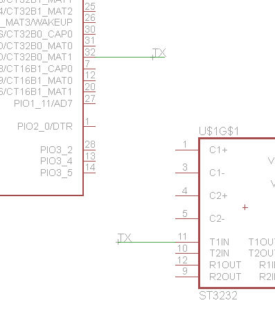

Is there a way to make the symbol pins "movable"/ "smashable" in the schematic editor, the way you can with the name and value?
No, but you can connect the pin to the net you want and then draw that net somewhere else.
Connect the net to the pin you want and end it a little ways out. Name it (name tool) and label it (label tool). Then start your net somewhere else. Name it the same and label it as well. Labeling just puts the text above the net line so it's not confusing.
In the attached example I have named and labeled a net called TX which goes from one IC to another, but the green line doesn't physically connect them.
I usually avoid this myself out of personally preference. I like to just trace the lines wherever they go.

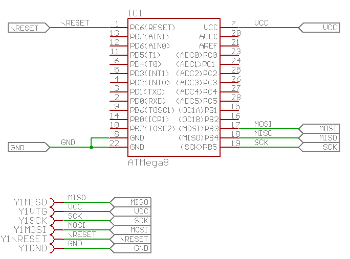

Using the same net name without physically connecting pins is a proper method. Instead of (or addionally to labels) flags can be used to mark nets.
That way the person reading the schematic knows exactly that there must be parts of nets somewhere in the design.

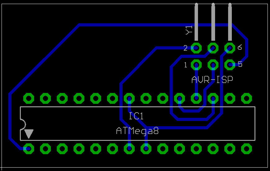

In case there any doubts about proper net connections my example also contains a PCB layout with all nets properly connected.

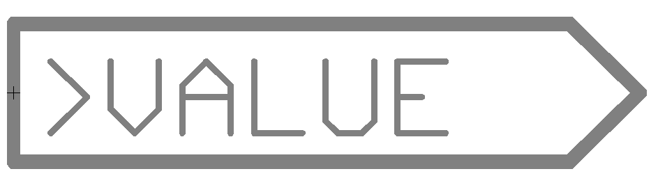

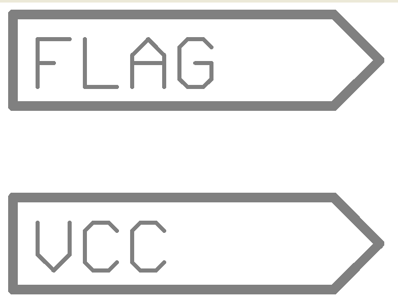

you can create a separate library for flags.
First draw the the flag with an arrow head as a symbol. Enter ">VALUE" and then create a device.
Flags have no pins and no package. You can change the text inside the symbol by clicking it and give it a value, e.g. "VCC".
