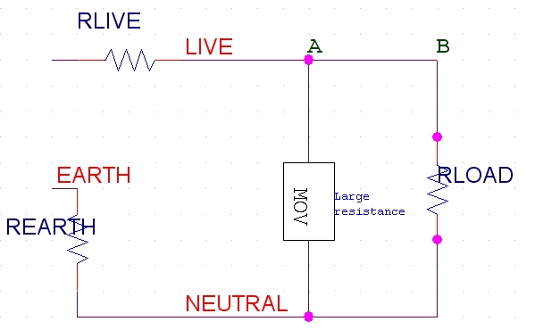

I read in how stuff works that:
"When voltage is too high, an MOV can conduct a lot of current to eliminate the extra voltage.
As soon as the extra current is diverted into the MOV and to ground, the voltage in the hot line returns to a normal level.
I'm not sure though why the extra voltage doesnt reach eventually to the appliance itself.
The reason that if V(A) equals 10KV, V(B) wouldn't reach 10KV, is due to the fact that the reflection coefficient in point A is:
Γ(A) = (0 - Zc) / (0 + Zc) = -1 ; (Zc is the characteristic impedance of the line)
and therefore the propogating voltage and the regressing voltage cancel each other?

The MOV will become a more like short when there is a voltage too high. Like a spark gap.
The current will split between the resistance from the MOV and the resistance formed by LOAD in series with the resistance between the Earth and Neutral.
Why are you using electromagnetics theory?
Thanks for the help.
According to what you're saying:
V(LOAD) = [ V(LIVE) - V(EARTH) ] / [ R(LOAD) + R(EARTH) ] =
= 10KV / [ R(LOAD) + R(EARTH) ] = Very large current.
If so, how does the MOV protect the appliance?
movs-jpg.35756
Ok.
Let's use the electrical circuit POV.
Rmov and Rearth are <1, lets assume 0.1 ohm .
R load >> 1, lets assume 9.9 ohms.
As you said, the total current is very large.
Rtotal = Rload + Rearth = 10 ohms
As 10 >> 0.1, Rtotal // Rmov =~ 0.1 .
So the Total Current =~ V/0.1 =~ 10*V Ampères.

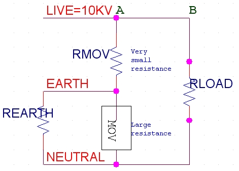

In your example:
R(LOAD) = 9.9Ω.
R(MOV) = 0.1Ω.
R(EARTH) = 0.1Ω.
The currents in the circuits are:
I(MOV) = 10KV / 0.1Ω = 100KA
I(LOAD) = 10KV / (9.9Ω + 0.1Ω) = 1KA
Indeed I(MOV) >> I(LOAD), but I(LOAD) is still very large and therefore is damaging the appliance.
Now without the MOV, we still receive:
I(LOAD) = 10KV / (9.9Ω + 0.1Ω) = 1KA.
So how does the MOV protect the appliance?

Alphacat, you used a voltage source with no series resistance. Add some series resistance to the voltage source and see what you get.
in a true short circuit, IE a 0 ohm connection the voltage goes to zero, in real world circuits this never occurs because EVERY portion of a circuit has a finite resistance regardless of how low it is. You have to keep in mind these series resistances and make sure you model ALL of these resistances properly or you'll get non-sensicle results like 20GA's of current being drawn. You can calculate the actual series resistance of your power supply by checking the no load voltage and the loaded voltage and determing the impedance that's there, but this doesn't work for switch mode power supplies.
There will never ever be 10KV across the MOV. The MOV will clamp at a much lower voltage (say 180V) and take the surge current (many many amps) until the voltage drops back down 180V.
Yes. After the voltage goes higher than, let's say 180V, it will act like a spark gap.
Alright thank you!
now I got you!
The reason that the voltage drops when the MOV's resistance gets very low, is due to the source resistance of the mains.
Thank you very much, its so good to realize that.
The real world is far far more complicated than the mathmatics show =)
Yes Indeed.
Though it was my mistake that i didnt take the source resistance into the mathemtical account.
I wanted to ask a related question please.
Is there any reason to use only one MOV in the following configuration?
relay-jpg.35800
If the source resistance is what counts, then i think it is not a good idea, since a large current drawn from the LIVE, which is shunted into the Neutral wire,
will cause R(EARTH) to have a large voltage dropout, so the voltage on the appliance remains high, isnt it?
