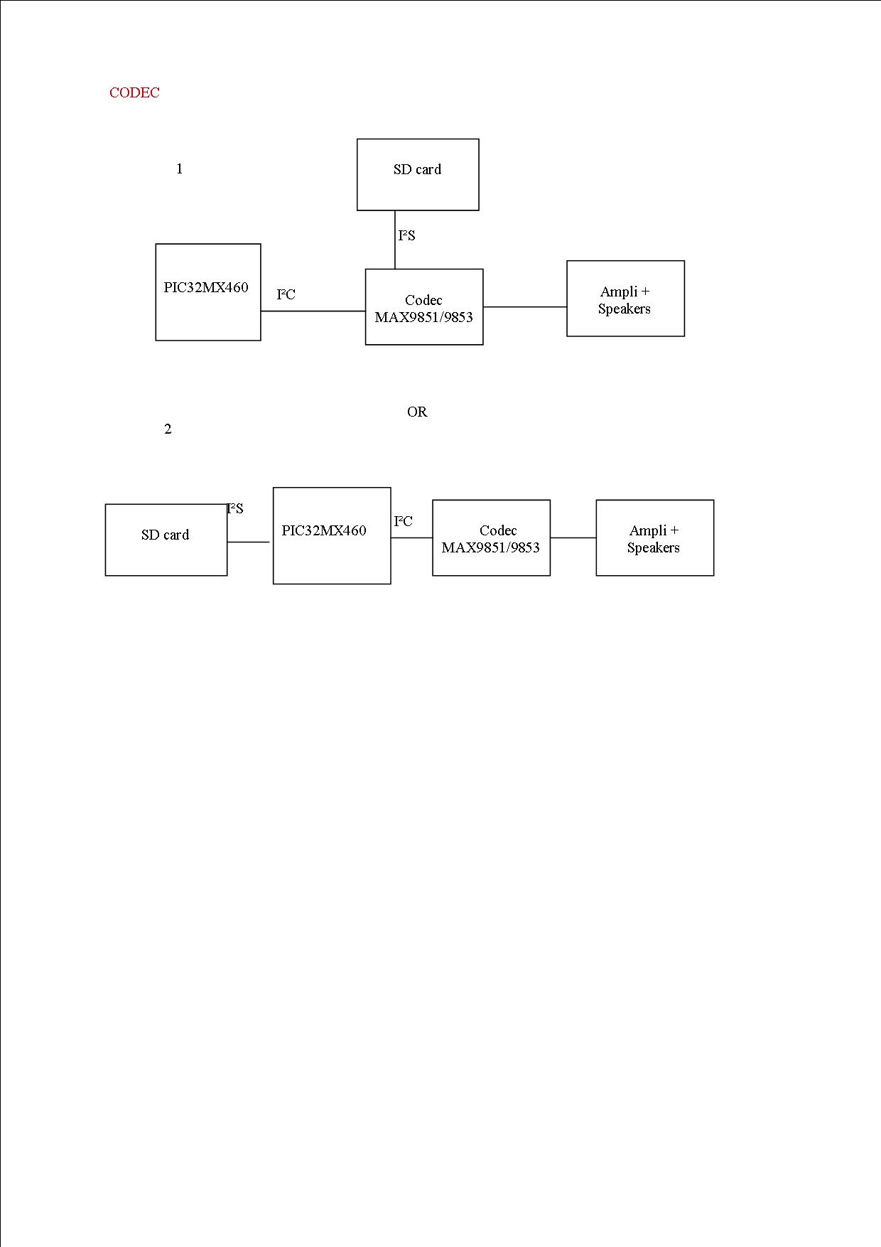

I want to realise a mp3 player as a part of a portable media player project. I've a PIC32MX4 micro. Data in a SD card.
What do you think about the followings schematics? I don't know if the first solution is ok.
Those aren't schematics, they're block diagrams, neither one of which make sense. SD cards can generally use an SPI bus, which may or may not be I²C compatible and I don't know of any SD cards that use the I²S interface. So you would use the PIC to read from the SD card via the generic SPI interface (or implement a proper SD card interface if it's possible) and then use the PIC to communicate with the codec via I²C which you feed into your amplifier. You might use SPI to the SD card and I²S to the codec chip but it depends on your needs and the full capabilities of the codec.
