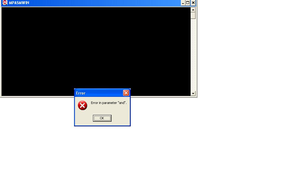

The problem is i get this error "error in parameter and", can anyone offer some advice as to what i am doing wrong.

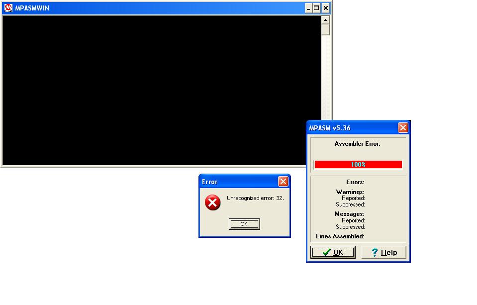

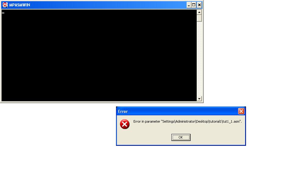

There are 3 stages to the error, the first being the "error in parameter" the other 2 follow after pressing OK

Yep thats the problem, eveything is okay now i have moved it to the C drive, many thanks for your help Nigel, something so simple as well

IIRC, for reference, MPASM Error 32 can also be triggered by spaces in the .asm file name.
OK, just tried and verified this, with a file which assembles correctly.
Renamed XXXXXX_XXX_XXX.asm to XXXXXX XXX XXX.asm and got Error 32 when assembling.
The filename/path length is also restricted to something like 62 or 63 characters in total, as pointed out by Nigel.
HTH.
