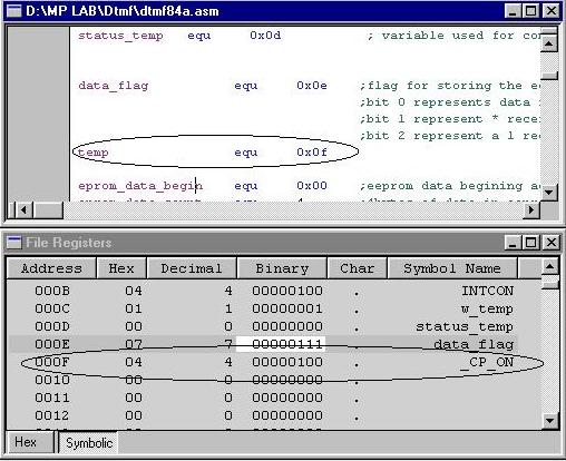

pls see the marked parts in the attached , this is on 84a
the temp register is mapped to 0x0f , but the register window shows _CP_ON
also u can see that the values actualy incremented , during execution ..now y display shows error ?
thanks
