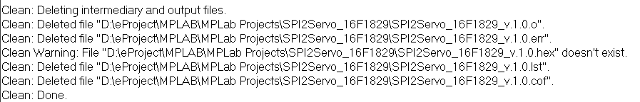

Sometimes, and I do not know what the variable is, after compiling, there is no <filename>.hex file . That creates a message, "Clean Warning: File '<filename>.hex' doesn't exist." (attached) Warning.PNG

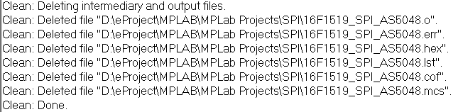

Here is an example of a very similar project file without the warning: No Warning.PNG
Nevertheless, the programmer will program a chip properly. If I close MPLab and open the folder with the project in Windows Explorer, I can find the .HEX (uppercase) in the folder for the project that compiles without the warning. The project that gives the warning has a file with no extension. That file is a hex file. I can rename it, .HEX, open the project and compile without a warning one time. After that, it get removes that "HEX" file (doesn't rename it) and the warning re-appears. The rest of the outputs look the same.

ADDENDUM: Tried a procedure found on an MC forum to solve problem. That was, go to Project>Build Options>Project>linker tab and set format to INHX32 That was already set, but what I found is that any change to the build options results in a good build without the warning for the FIRST build. Subsequent builds then give the warning.

FOUND IT OR AT LEAST ONE OF THEM
Grasping at straws, I noticed that my habit of appending version numbers to the Assembly file seemed to correlate with failure to find the hex file.
Example (warning: no hex file):
Notice project name and file name are different. The file shown without an extension is the hex file.
Example (no warning message):
