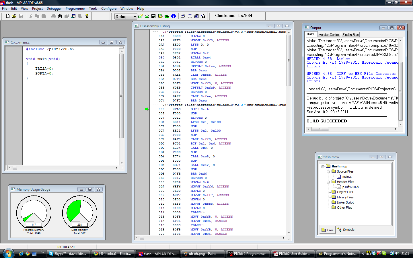

I am having a unique problem with my C18 compiler. For unexplained reasons compiling a really simple program over half my data memory is used. Below is a snapshot of the problem:
lots-of-ram-png.52373
as you can see the very simple program is using 268 bytes of data ram without even any bytes defined.
I am using a PIC18F4220 with MPLAB v8.66. The C18 compiler is the most recent free version of the microchip. I can zip the whole project if you wish or submit individual files.

Check out the linker file ....MCC18\lkr\18f4220.lkr
You will see that 0x0100 bytes (256 decimal) is reserved for the C18 stack.
Your program only "uses" 12 bytes.
Hope this helps

Is there a way to lower this or is it set permanently?
To change stack size you can-
1 edit ....MCC18\lkr\18f4220.lkr
or
2 copy the .lkr file to your project directory, add it to your project, then edit it.
or
3 leave everything as it is. When your program gets bigger, C18 might need the stack space
