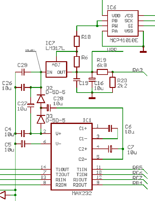

my laptop does not have an RS232. I need some sort of USB-to-RS232 adapter.
Would this work flawless for my ICD2 clone?

Or you can modify a USB to RS232 and wire pin 9 (ri) via 1N5817. Then a simple wire from 9 to +5 on the Inchworm. I've done that.
Or better yet just power it from your project.

But would ANY USB to COM adapter available at local elec store work?

Bill, someone told me you can't pull power from some of those USB-to-232 adapters.
That's why the big 10uf caps. Some of the newer MAX232 (with the 0.1) have wee drivers and may not like to have much current drawn from them.
The old & cheap Ti232 that wanted the 10uf in the first place can deliver the small amount of current required to get VPP up to >12.
Check out the doubler Aprrox 18v on the USB / RS232 with programable VPP. You've seen the schematic before I'm sure. It even runs it through a LM317

Opps had the wrong USB - RS232 in mind lol.
You're not supposed to, most USB ports have max 500ma and many less than that.
I usually run my ICD2 emulator from target power
