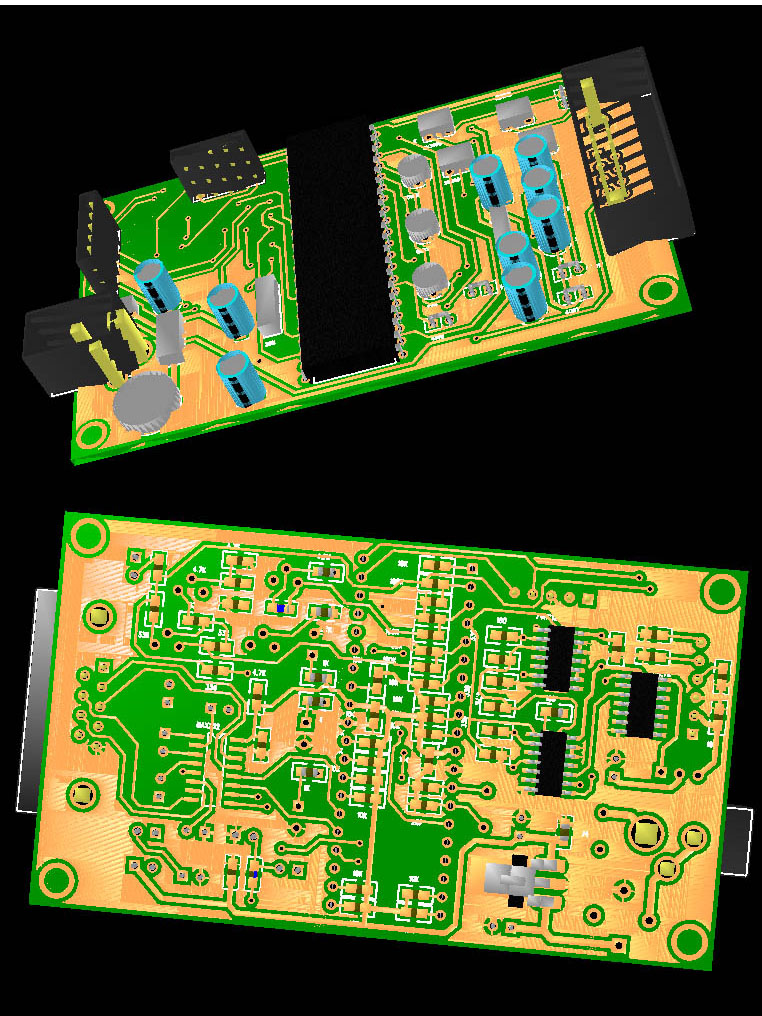

I got this PCB of RS-232 ICD2 from a friend of mine.Kinda DIY stuff.The MCU implemented is PIC16F877A,while its HEX file is from a cyber resource without source code.I managed burning the chip elsewhere and detecting the ICD in MPLAB.But an error occured during the self test phase as below:
Connecting to MPLAB ICD 2
...Connected
Setting Vdd source to target
ICDWarn0020: Invalid target device id (expected=0xE2, read=0x0)
...Reading ICD Product ID
Running ICD Self Test
... Failed Self Test. See ICD2 Settings (status tab) for details.
MPLAB ICD 2 Ready
I accessed the status tab and found the settings there,but don't know how to prevent such error from occuring again.I suppose there's something wrong with the hardware,most probably the supply voltage.Could anyone offer a clue?By the way,I have 6 free samples of PIC16LF877A.What exactly is the difference between it and F877A?Only low voltage?

Your problem are voltage levels, can you take a screen shot of your measured voltages (MPLABs windows of them), also take a Voltmeter and measure them in the ICD2.
16LF877A should be the same as 16F877A, but make sure you have the special 'A' bootlader version (standart ICD2 bootloader is for non-A versions of PIC16F877).
Thanks Jay I think I found the problem - the power supply is too high.I found it in the tab this time.Then I when to the MPLAB help file for power supply standard.It says 9V.I used some other programer's transformer with nominal 12V output just becaused the ICD2 is a DIYed device with no wall cube coming along.
Will 12V(actual output around 13.3V)cause a real problem during usual operation?Do I have to get a new power supply of 9V/0.75A?

First I have to make it clear that I didn't design it.It's from a friend of my friend's.
I believe this very man didn't design the whole stuff either.He must have got some info from a website and did some modification.I know this website and I have a pdf from it explaining how to DIY an ICD2.But unfortunately both the site and the file are in Chinese,which most of the people here don't understand.Yet I think there must be some English site with samilar information.Why don't you do a web search?
I lent someone my digital cam,so I can't take a shot of the real stuff right now.Just copied a 3D image generated by Protel.Sorry for this.If you need a picture you may need to wait a few days :)
