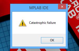

Something has happened to Mplab and when I start it just gives these two error messages.
Have un and re installed with the same results.
Have then uninstalled again and deleted all references I can find to Mplab in the Users folders etc but a reinstall just gives the same results.
If I go to Mplab in the Admin account it works fine; also creating a new standard user, Mplab is in there automatically and it works fine.
Anyone have an idea of how to get it working again in my standard user account ?
( I did have Mplab X etc in this account as well, but have since uninstalled it all.)

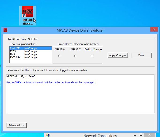

When you install MPLABX it also installs a driver switching program, this allows you to switch the drivers between MPLABX and MPLAB.
Presumably the drivers are still switched for use with MPLABX?, thus preventing MPLAB working.
You might try reinstalling MPLABX, and then use the driver switching program to select MPLAB.
Thanks Nigel, but have just tried it with no effect.
I only ever had it set up with a Pk2 and Pk3 which according to this Microchip page, they use the same common driver for both version; its just the higher end devices that need their drivers changing.

You should see the short cut that is normally installed with MPLBX called 'MPLAB driver switcher' that Nigel is referring to.

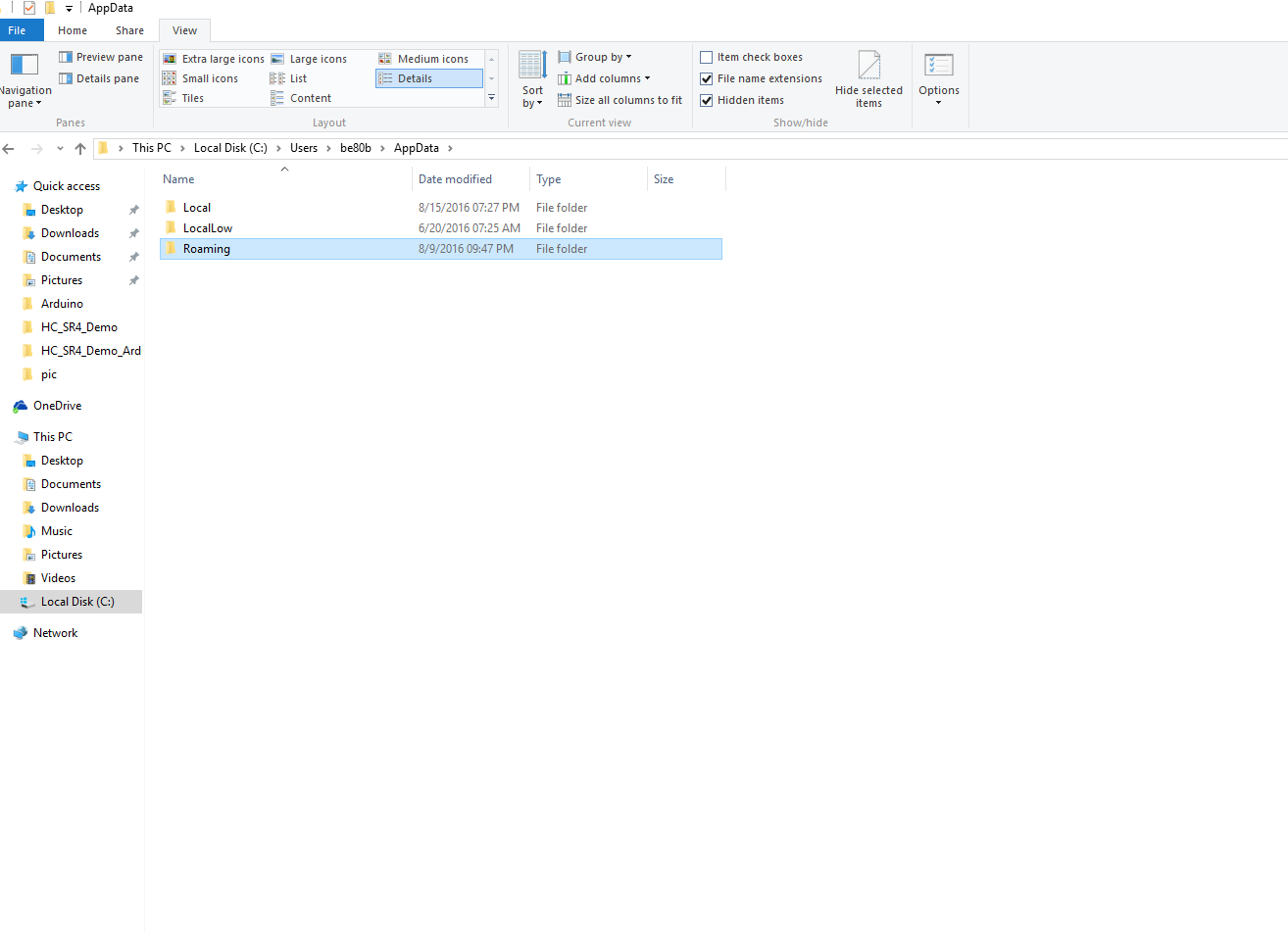

But if you go to C users and click on the user your having problems with then at the top click view and show hidden
Then look for app data you should find a Mplab file with user setting that's more then liking your problem
Here some pictures to help you find it
The problem I ran into was drivers but it was after a update. So I turned it off.
